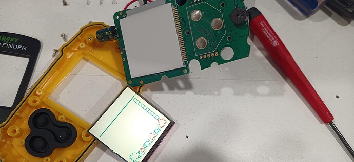

I want to interface the same Lucky fishfinder as the older post on arduino (200 khz transducer / 45 Degree / max 100m). I openned the handheld device with the screen and realize that reverse engineering will not be possible. I have another idea. This sonar come with a lcd screen and the screen is driven by this chip: HT1621B datasheet
I am thinking to connect the arduino on the lcd driver and take the data I want out of it to the arduino.
This way I could use this fishfinder in my ROV.
My problem is I have no clue of where I can take the data out of the HT chip and if I will need to condition the signal for the arduino?
Can someone help me with this? As you can see on the picture, I have access to the whole thing.
Thank you

It takes a lot of work to reverse engineer a direct LCD driver interface, but this is how to start the process.
Less creepy link to a datasheet for that part: https://www.seeedstudio.com/document/HT1621.pdf
Do you think that the data are produce in the HT or maybe the HT only receive the numbers from another chip and just drive the LCD? In such case, my point would be to connect on the data in pin of the HT not on the data out to lcd pinssssss.
In the datasheet, pin 4 is named "data". If I hook up there, I might receive the data directly?
The HT is only a seg/com driver. They're sending it pixel data from "the brains of the operation" -- another MCU.
What are the other two ICs on that board?
The HT turns on and off LCD pixels that can be any shape or size and located anywhere on the LCD, similar to how 7-segment displays work. All of the intelligence is in the microcontroller.
The only way to get data from the LCD lines is to follow the reverse engineering procedure linked in reply #2.

The other IC is : N76003AT20 page 11 of this datasheet
One last thing, on the first picture, we can see 5 solder pad in the lower rigth part. They all seem to go to the N76 IC. If we are lucky it is for QA testing and data could be monitor there? Maybe I will see something on a serial monitor?
To Blackfin, thank you for the LCD link. It sure look hard to do. I hope I will find a different way but it's good to know there is an alternative outhere.
So the N76' is an 8051-based micro and is the brains of the outfit, so to speak.
TBH, I don't think the raw data you're looking for is going to be broken out anywhere. The microcontroller will likely just drive the transducer circuit, process the data internally and clock pixel data to the display driver.
The 5-pos connector footprint may be for a serial port, used for factory testing or it could be, say, a programming port. You'd need to do connection checks between each pin of the connector and each pin of the micro and compare that against the controller datasheet to get a better idea of what it's for.

I finded time to look into the circuit in more details. It is too big to be ruled in one post... I would like to share were I am now before I go further. your input will help understanding the next step.
1- The LCD driver is essentially driving the LCD. I think it also output a clock signal to the transducer (switching the transducer accumulating capacitor maybe?) at a certain frequency. Thus triggering timed pulse. There is 4 com and 31 segment. A big job to hack with the arduino trick.
2- I tried to connect to the microcontroller with a serial device on the soldering pad. They are connected to RX / TX of the microcontroller, V+ and gnd. But I was not able to see or trigger any data transfer event. I used realterm and a rs232 cable "spy". Rx or tx was not blinking or doing anything.
3- The AA32416 IC (on the right corner) is were I choose to invest time for now: I figure out all the IC pin connection and this is were I need your help to go further.
Of the 16 pins, only 7 are connected and strange enough, pin 9 (IC final output pin is not connected - or I failed to find the link yet). I was expecting a lot from this pin.... (: What this IC do with only 7 pins? Can someone figure this out with my finding below?

It sounds like you are on the right track.
The aluminum shielded coils are most likely tuned impedance transformers. They could be used for the echo receive input circuitry and/or to increase the transmit voltage.
Do you have an oscilloscope, to follow the signal path? That would be a great help. It should be easy to identify the transmit pulse, but much harder to follow the return signal.
