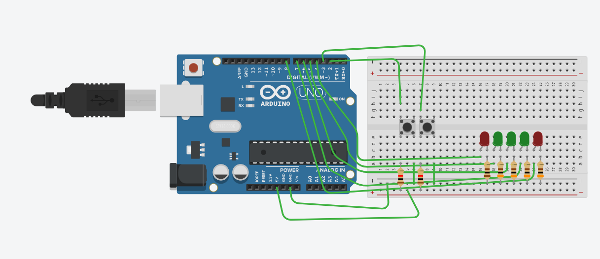

Hi, I'm trying to control the speed of some LEDs using two buttons (one to increase and one to decrease) using interrupts but it only triggers the function once.
Here's my diagram and code

It works in the simulator but not in real life.
how did you wire the buttons in real life and not on the model? best would be to connect in diagonal across the button to avoid connecting to 2 pins that are "the same".
using the builtin pull-ups would make it easier (just invert the logic)

What does it do in real life?
Do any of the LEDs light up?
What does the serial monitor show?
Are you using an Uno R3?
Yes, I'm using UNO R3,
LEDs light up in both real life and in the simulator
It just the speed that's not working (changing) in real life.
In the serial monitor speed changes just once (+-20) and then no matter how many times I press the button it doesn't work

Your circuit is fine, no need to change it
but important to implement it in real life in the same way (eg it's easy to turn the buttons 90° and get it wrong)

I was using this breadboard and here all the vertical lines are not connected. It's connected in block of 3. So my common ground wire was working for the leds but not for the buttons as they were further away. @J-M-L suggestion of using builtin pull-up also made the circuit simpler.

There are no vertical lines on that breadboard, it is at about 45 degrees angle to the camera. So there are are only SE-NW and SW-NE lines. Please explain what you mean.
What is connected in block of what 3 items? Again, please explain what you mean.
I can see exactly what is connected to what on your breadboard simply by looking at it. But I am familiar with breadboards. I want to check that you truly have understood what is connected on your breadboard, to avoid more problems in future
