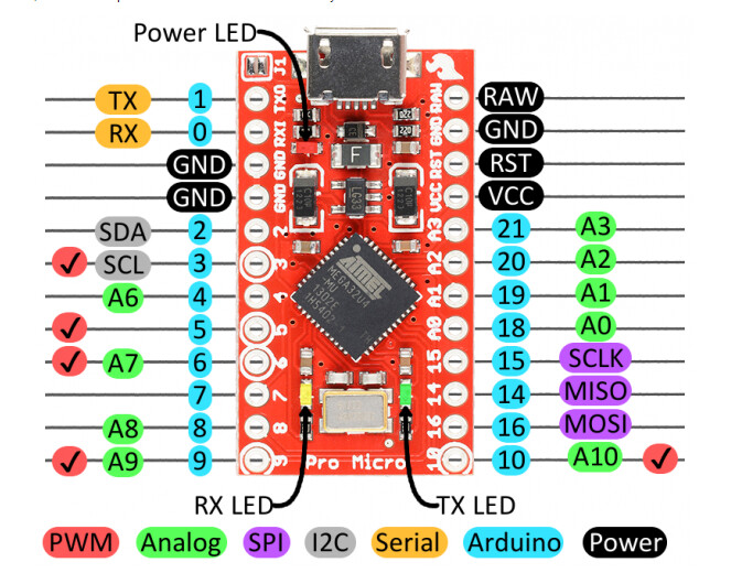

Is one of my pin dead ?
I'm trying to test my board pins, because of some I2C errors I've been having, and I think I found a potential cause :
I'm using an Arduino Pro Micro 3.3v, and I'm testing pin 2 and 3, the one for using the I2C.
Pin 2 seems to be working, it display seemingly correct results.
Pin 3, on the other hand, seems to be bugged : it doesn't seem to send anything, because the analogRead of Pin 9 doesn't change in correlation with whether it's connected to it or not. Could I have found the issue ? Or is it just something simple that I'm missing ?

Yup, tested all other ones, they all respond normally, exept for Pin 3... Could it be that because it's the SCL pin it behave differently ? Or is it just ded ?
If you connect a LED with series resistor on 3, does the blink sketch work with pin 3 ?
I tried it with Pin 2, 3 and 4 but without a resistor, and it works on 2 and 4, but not 3.
What would the resistor accomplish there ? I'm not very good with electronic just yet, would it make a difference ?
The resistor is used to limit the LED current to a safe level that the GPIO output pin can handle.
It does appear your pin 3 has been damaged.
In the future, keep out currents to a safe level, a good rule is no more that 20mA.

Pin 9 is not an analog input pin but just a digital pin I believe.
Heya !
I'm following this pinout :
So I believe Pin 9 is an analog, and I've tried digitalRead and analogRead anyway x)
Do you know how it could have been damaged ? I only used it with an I2C accelerometer, which shouldn't require resistors...

Most accelerometers are 3.3V only, but the Pro Micro is 5V.
You need a logic level converter to make that connection. Otherwise you can destroy one of both of the connected devices, and that may explain what happened in this case.
