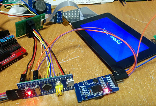

In both cases, adding a variant, involves immersing yourself in the paths that led you to see a "blink" and is not a simple task.
Other approaches emerged, which simplified the addition of variants, we know them as "generic cores": danieleff, ChrisMicro or huaweiwx. Unfortunately their jobs were stopped around the F7 plates. But they managed to add a lot of variants.
The core whose procedure to add new variants turns out to be the most reliable is that of danieleff.
You can handle the F407 series very well as the VE mentioned by Francisco-Colli at the beginning of the post.
It has a good amount of 100% functional fundamental libraries for STM32: SDIO, an optimized SdFat version, SPI, Wire, can handle EEPROm through the AT24Cxx library.
It can handle the DotStar library, DotStarMatrix, GFX_AS, DHT and sensor.
Best of all, it has allowed me to handle screens of the FT80x, FT81x and recently BT81x! series, modifying the gameduino library 23X, harnessing the power of the SdFat library that is included in the danieleff core.
Given the first comment "about ease of learning", my recommendation is that you familiarize yourself with the danieleff core, which will give you the basis to advance to the official STM32 core, and, looking beyond that border: get acquainted with the STM32 HAL.
