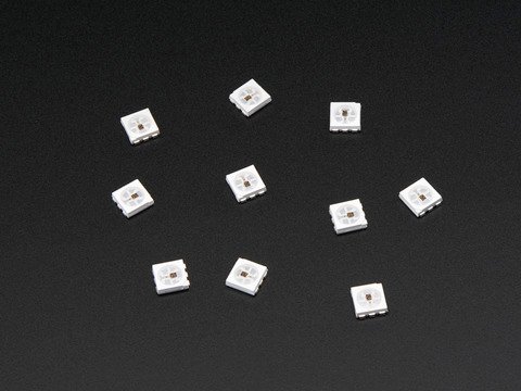

Or, with ground, digital pin (on Arduino), plus external power (+4-7V) you can control a whole bunch of these RGBs —
