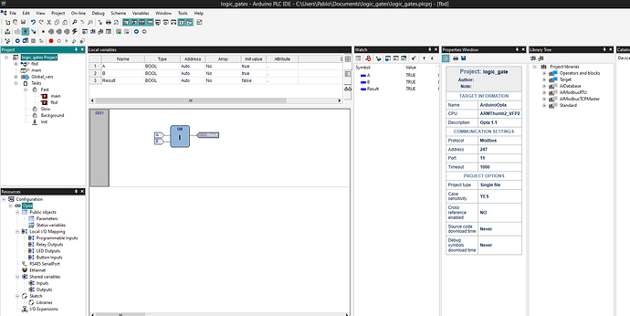

Please look at the screenshot. I purchased the opta recently, I experienced my first issue with downloading a sketch from the IDE PLC and got a download failed. I emailed support for help. It's been 2 weeks and no reply. Just last week, I combed the forum and found that the fix was to upgrade the IDE PLC to version 106. I did and that resolved the download issue.
Now my issue is what you see in the attached screenshot. You can see that when I set it to debug mode and wanted to test a simple logic of OR and EQ, the output remains FALSE even when the input works (TRUE). I have emailed support for this issue, and it's almost a week no reply from them. I even put the issue on the forum and have not had any luck from anyone yet.
So please look at the picture, and if you can recreate function block and see if it works on your opta I would appreciate it. Thanks in advance

Can't help much with that (Arduino made the IDE PLC only for Windows, I don't use that).
Sorry about not helping. I am not familiar with the IDE PLC and am unable to make sense of your picture. Without having the Opta, I am unable to do any testing either.
Your picture is completely different than the Arduino IDE. I am accustomed to seeing all text for the IDE. Arduino sketches are lines of programming code and are shown on this forum in code blocks like this.

it's not the usual C/C++ targeted IDE, it's the PLC IDE
Thank you for making sure I was aware of the difference. I appreciate the confirmation that the image is normal for the PLC IDE. Such a big difference between the two IDE’s probably means few members here understand the Opta PLC system. Am I correct in this?
Yes, I've not seen much discussion here about that IDE in general, but that's the right sub-forum

Hi!
I have just checked and it works for me
Make sure the program you showed, is inside a task, if not it will not run.
Feel free to share your project if you have doubts
