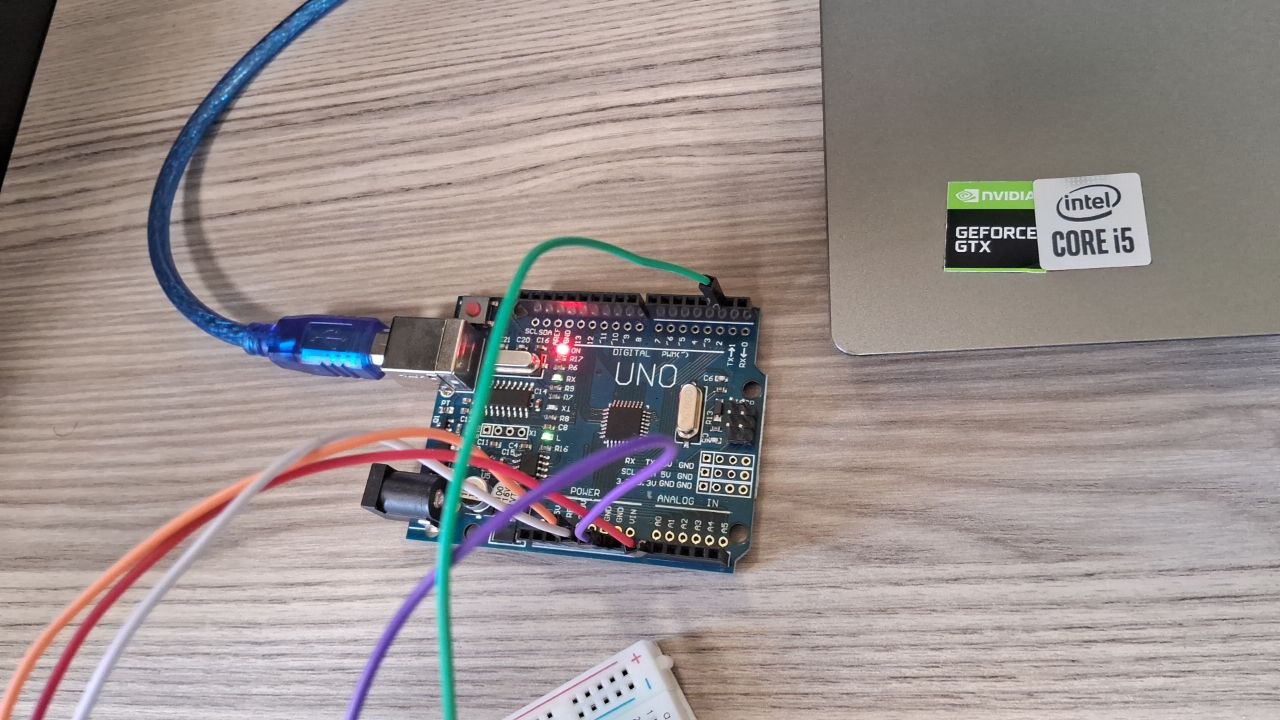

double thermistor(int val){
double temperature;
temperature = log(((10240000 / val) - 10000));
temperature = 1 / (0.001129148 + (0.000234125 + (0.0000000876741 * temperature * temperature)) * temperature);
temperature = temperature- 273.15;
return temperature;
int value = analogRead(A0);
double temp = thermistor(value);
Serial.println(temp);
delay(50);

In the IDE, on the Menu bar, click on Edit then on Copy for Forum.
Then paste your code here. It will be easier to read.
Do you have a DMM/Multimeter?
No sir, the problem is, the place where I bought the thermistor told me that it is NTC. But when I build the circuit and write the code, I cannot see any change whether I heat or cool the NTC. I wonder if there is an error with the code I wrote or is it in the thermistor?

Well let's see if it actually works.
Try this code:
It will print the ADC value and temperature.

Is the white wire GND and the orange 5V ?
Post a simple schematic showing how it is wired, the picture does not do it for me. Be sure to indicate polarity on the connecting leads.

The only information we have about this thermistor is that it's green .
Koepel
June 28, 2024, 11:40am
10
It can be a NTC, a PTC, a fuse or a capacitor.
Can you ask around if someone has a multimeter ?

Put the thermistor in line with a resistor and LED. Adjust the PWM to see the LED glow a little. Cool and heat the thermistor. Some of these need to be very hot. I used an NTC in a 50A circuit to slow inrush current.
