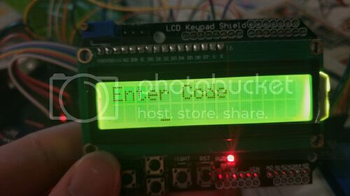

Hey there all,
I'm pretty new to arduino and c++ programming, please forgive me if this is in the wrong place.
I am having an issue when trying to input a code with the buttons on an ebay LCD keypad shield on a "Funduino" mega
The program is designed to sit idle until the select key is pressed. Once that happens, it prompts for an 8 character code, then displays the code back and moves on to the next function.
The issue I'm having is that when I enter any key, it immediately populates the code with that key, and displays some odd character afterwards.
I have modified a different project to suit my needs, and it works mostly to my satisfaction except for this.
Any help is appreciated,
Thanks!

EDIT Pics of Password error
I tried to have a look at your code.
It is hard to understand what is going on.
I have to suggestions:
  1. spend some time in the formatting of your code
  2. place more of your code. and add some comment
Things that may be your problem:
  1. what is the intial value of currentLength? maybe it is not zero
  2. debounceDelay may not be large enough. try something ridiculously long. I would try it with 1000, to make sure the logic in my code is correct or not.
Nothing else comes to my mind at the moment.

I think the password works fine just it does not show correctly...
According to my opinion, as the input password type is character and the matching password is also character type so when you entered the right code, your code matched and it works as your demand but when you display it, its type is in integer and it shows in convertible form as ASCII...
So if you want it to display correctly then you have to first convert it into ASCII form before print or you can just print it in hidden form i.e. ****** the easy way just like the other passwords....
