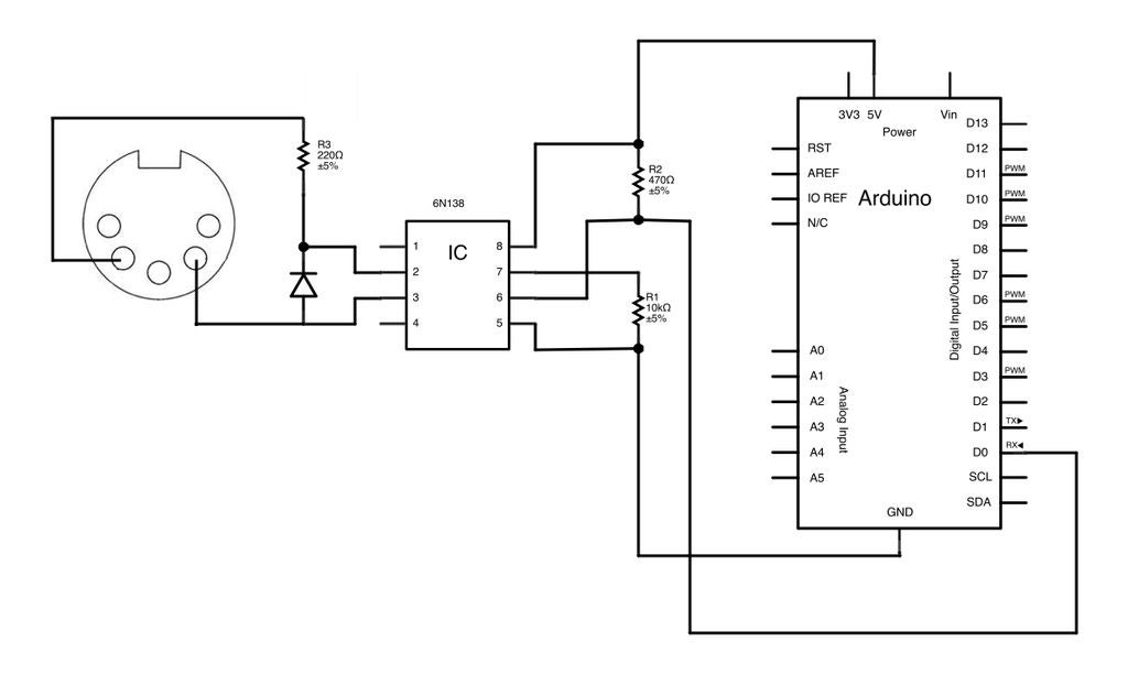

I have a Roland TD-17 electric drum kit that has a MIDI out jack. I am sending the MIDI into an UNO to control 4 meters of an Adafruit Neopixel strip. I've managed to get the LEDs quite responsive however I am running into an issue where the LEDs get "stuck" lit up when hitting multiple drums at once. This does not always occur but if I really overload it with "overlapping" MIDI notes (not really because serial port) it happens more often. Here is a video I have uploaded to Youtube showing the issue:
I've attached the schematic I followed to receive MIDI as well as a photo of my breadboard to elaborate. Here is my code:

I am sure there is something I am misunderstanding about either the wiring or the "setHandleNoteOff" command. Any help would be much appreciated! ![]()
