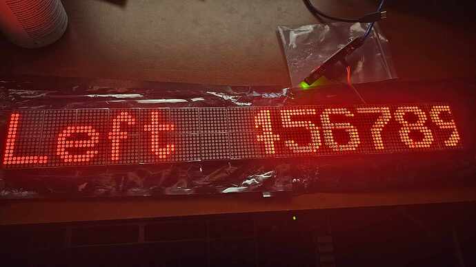

Hello everyone. I am struggling a bit with the max7219 modules I bought from Aliexpress recently. I want to build a big led panel with dimesions 16x128 pixels with a total of 32 devices. My board is Arduino Uno. I have got 2 FC16_HW modules, 16x64 each, which I soldered together.
I am attaching a picture of the single module and its wiring.
After I soldered them, the wiring looks like that:
I am using the example code from the parola library - Parola_Double_Height_V1
Initially I set in the code HARDWARE_TYPE MD_MAX72XX::FC16_HW , MAX_ZONES 2 and ZONE_SIZE 16 to make 2 rows so that I can make big scrolling text. This was the result:
Text begins scrolling from the bottom right module which is the entry, when it reaches the eighth module, the text goes to the upper right corner, then it goes to the lower left and finally upper left. I tried setting other values for HARDWARE_TYPE but it was getting worse. I confirmed that my max7219 modules are type FC16_HW when I tested the example project MD_MAX72xx_Dynamic_HW which prints the type on the screen.
I tested different ways how to fix this issue. I made 4 zones for each panel side and I can print readable double height text separately on the right and left sides of the led panel.

I still can't find a way how to merge the left and right sides to show centered text. I first soldered each panel row DOUT to the DIN of the second panel row but it was messing up because the end of the 1 row is already connected to the start of the 2 row of the same panel. Then I soldered it again as shown on my picture above. I think the only solution could be codewise but I would appreciate any other advices. Does anyone ever used that 16x64 module before?

I was thinking if it is possible to define zones not just by passing the index of a start module and the index of the end module which the setZone() method only accepts as parameters. Since per row, the first group of 8 modules is not directly connected to the second group of 8 modules, how can I pass the indexes of each module? It my case the lower row is made of modules with indexes [0,1,2,3,4,5,6,7,16,17,18,19,20,21,22,23] and the upper is [8,9,10,11,12,13,14,15,24,25,26,27,28,29,30,31].
The text will move 'down the line' from the first connected module to the last. If you zig zag the witing in the middle, like you showed, then the text will go that way, as you saw happening. The modules in a zone have to contiguous (ie, from the 'start' to the 'end' module), you cannot pick and choose which modules go in a zone.
If you want to have one display with 2 lines (top and bottom as a double heigh display) you need to wire them as 2 lines, not what you have done.
Please read this Parola A to Z – Double Height Displays – Arduino++ (wordpress.com). To fix the issue you need to revire the central part of the matrix.
