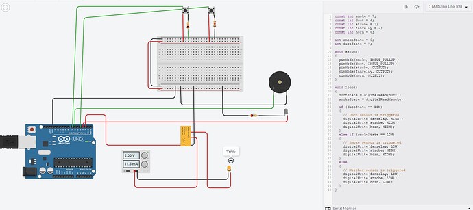

I can't seem to get this to work right. Anytime a button is pushed the orange light will turn off and it is supposed to only turn off when the top right button is pushed. It might be the way that it is wired, but I am not completely sure what I am doing wrong.

Looking at your frizzy drawing I would suggest you purchase some more Arduinos as you are apparently driving the relay coil with the Arduino pin. No clue as to how this is powered or how the buttons are connected. A regular schematic would show all of this nicely and probably less work to generate.
Why do you use resistors to ground and INPUT_PULUP? Just wire the buttons between pin and ground and use INPUT_PULLUP.
Please do not post pictures of code; nobody will type it all to test. See How to get the best out of this forum how to ost code using code tags.
