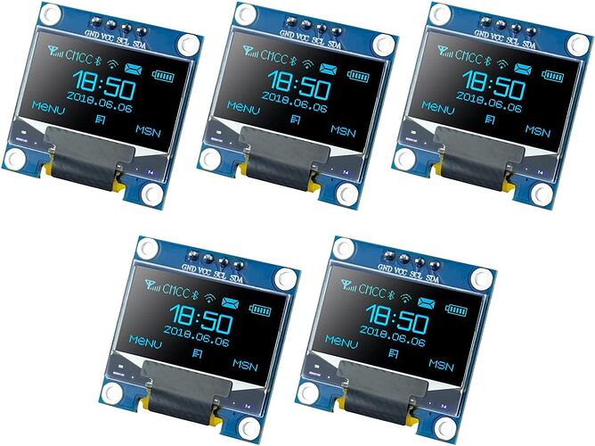

These are small but easy to use and are inexpensive, ≈ $5 each.
I2C, SSD1306

Hi, I know.. I have those
but they are small, i need something about 4,3" and bigger resolution... And somthing says me that its going to be expensive xD
