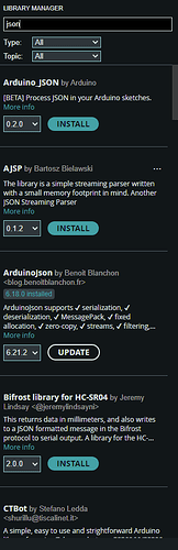

Using Nano Every with with temperature/humidity sensor and LCD. Keep getting arduinojson..no such file or directory. Tried #include <ArduinoJSON.h> but same message.
From where you get the hint of it?
Did you install the library? If yes, which one? Randomly changing includes is not going to work.
Please post your sketch.

No if you are getting error no such file found which clearly indicates that you have not installed the desored libary
Kindly download the desire so that the error can be resolved
I am not sure where to find the library. Please advise
That is, Nano Every ! Please tell us which library you are exactly using, it was asked before. If you installed it using the library manager, show the one that indicates "installed".

I tried to download library and got this message:Downloading ArduinoJson@6.20.1
ArduinoJson@6.20.1
Failed to install library: ArduinoJson:6.20.1.
Error: 13 INTERNAL: Can't download library: Get "https://downloads.arduino.cc/libraries/github.com/bblanchon/ArduinoJson-6.20.1.zip": proxyconnect tcp: dial tcp: lookup _: no such host

Comment-out the line:
// #include<json.h>
It is not used.

If the installation of the library fails, I'm not surprised that you get errors when you try to compile a code that uses that library.
If you still have the download error when trying to install the library, I suggest that you start a new topic about the error that you get in IDE 2.x - Arduino Forum ; this error will probably keep biting you if you don't solve it.
You can download that library using your web browser and install it manually; use sketch → include library → add .zip library as shown below.
Point to the downloaded zip and installation should work.

The sketch you posted in Post #11 works if you delete the line:
#include<json.h>
The simulation of YOUR SKETCH with the "json" line removed is in the link in Post #12.
