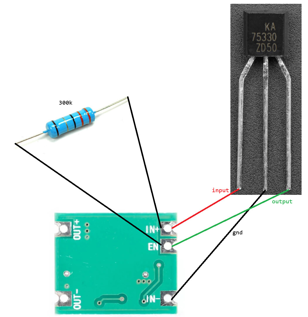

KA75330 not pulling output low
I wired a KA75330 to the Enable pin of a buck/boost voltage regulator (B628 IC), which is powered by a lithium cell, with the intention of making the voltage regulator turn off when the battery discharges down to about 3.30V. The buck/boost module that I'm using exposes the Enable pin, but there is no built-in pull-up on the board, so I added a 300k pull-up which is required to turn on the regulator.
The problem is that the KA75330 is not pulling its output pin low, so the regulator never turns off, and being a buck/boost it will discharge the battery down to 2.00V or less. It went as low as 2.70V when I was testing it.
What did I do wrong?

Added the relevant links to the original post.
Are you sure 300k pull up is ok. I have often seen 100k used there.

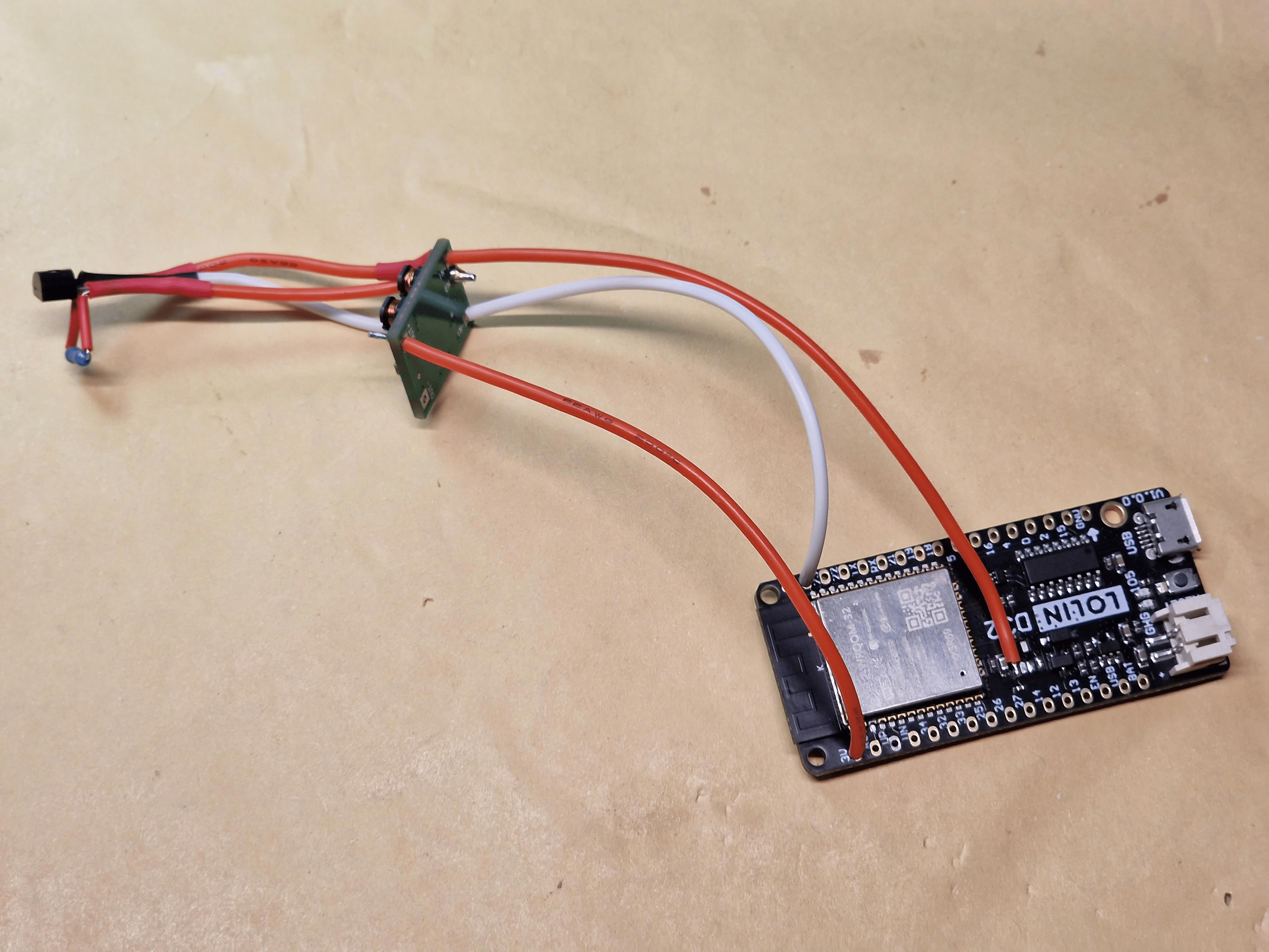

Post a real picture of your setup.
Leo..
Looks ok, it should work. I suppose that you have already checked with the tester that the output pin doesn't go to zero.
Maybe the voltage detector is not working. Test it alone with 5V and a potentiometer forming a voltage divider. Check that the output pulls to zero when the input voltage goes below 3.2V (thresold - hysteresis).
The output should be pulled up, as you did. Try with a smaller resistor, about 50K Ohm. Actually it should short output with GND.
That made me look at the circuit again. It's actually the other way round.

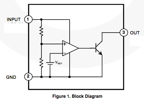

Figure 1 on page 1 of the K75330 datasheet suggests that the output is LOW when the supply is >3.3volt. So the converter turns off if the battery is higher than 3.3volt and on when the battery is below 3.3volt. The opposite of what OP wants.
Leo..
Ah, of course, you are absolutely right. When the detector is above 3.4V it shorts the output to GND. That's why it's not working.

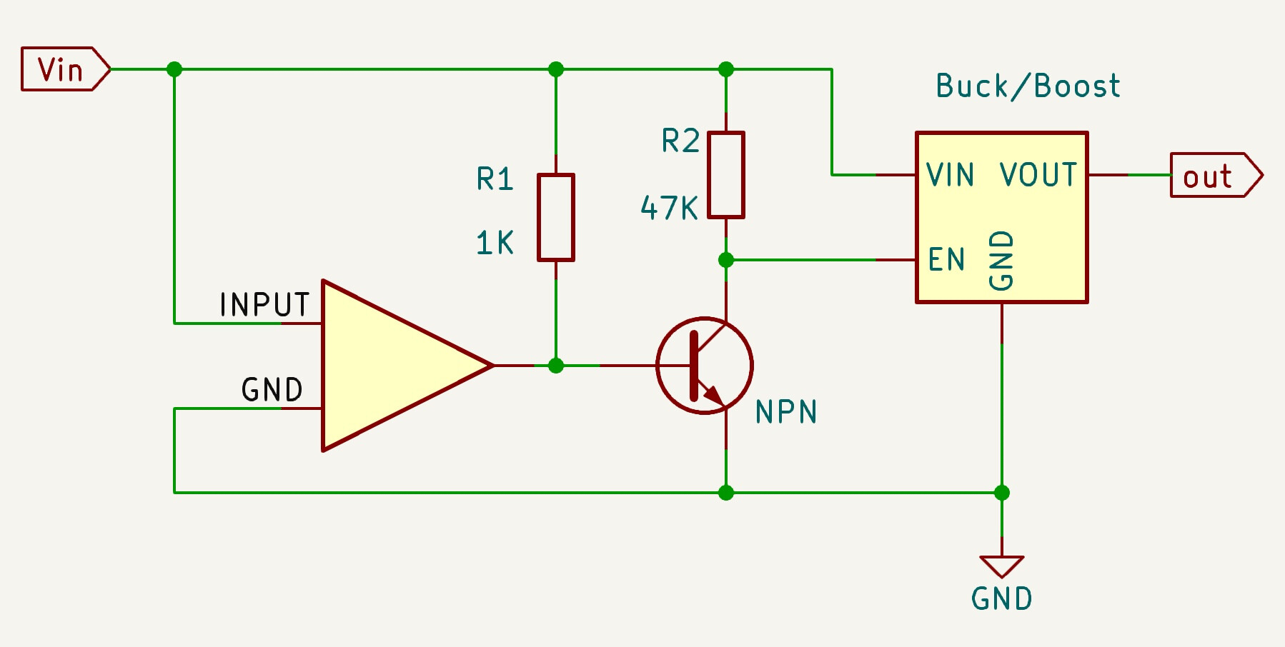

Then a NPN transistor could be added to invert the logic. Something like this:
When Vin is above 3.3V, then the output of the detector is connected to GND and the BJT is off, so EN is high.
When Vin goes below 3.3V, then it's output get's floating but tied to Vin and the mosfet will be on, pulling down EN.
(R1 value should be checked)
Yes, and extra inverting stage is the solution.
R1, R2 can be much higher though, like 1Meg, 100k.
Leo..

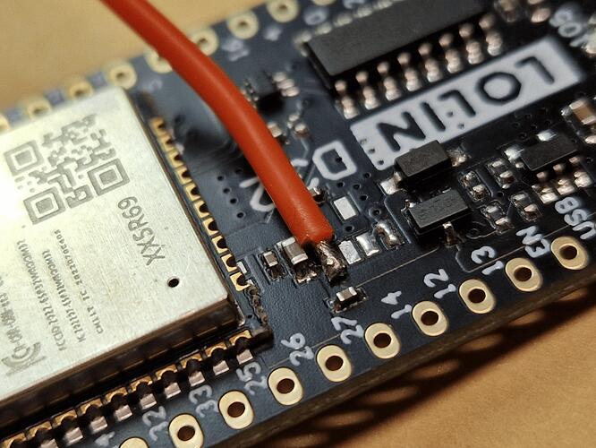

The original linear regulator on this board was rated for only 150mA, I removed it and replaced it with my own buck/boost regulator.
There is a solder bridge next to the MOSFET, it is intentional. There was a 100k pull-up for the Enable pin of the original linear regulator.

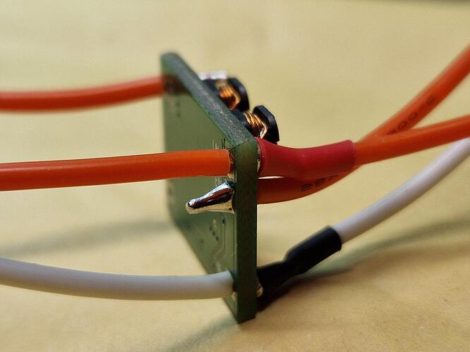

I replaced the potentiometer in the buck/boost module with a 9k resistor, the other half of the voltage divider is a 2k resistor.
300k pull-up for the buck/boost regulator, it would not start without it.
If you have to add a couple more components, first I would connect everything in a breadboard to test and adjust. And draw a proper schematic first, it will make the work easier and less chance to make mistakes.
When it works you can solder the parts in a small perf-board, or without it, dead-bug style like you have now.

How are you measuring this? The output is open collector, so you have to measure voltage between the input and output pins, not ground and output.

This would be consistent with the output off, so floating. But when the voltage detector is active the resistance between out and GND should be very low, close to zero.

Ok, could be. But the datasheet diagram seems to indicate that.
