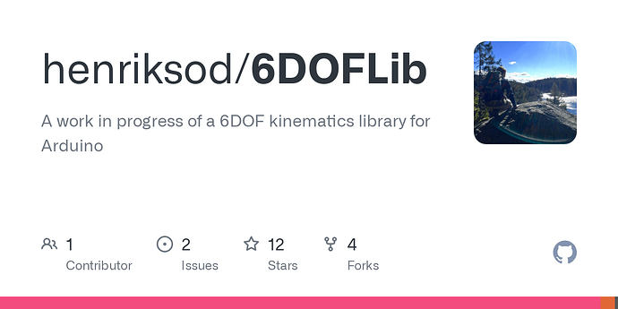

I have begun working on a library for this. It is currently uncommented and unusable since the inverse kinematics is not quite done yet. Forward kinematics should work, though. The plan will be to make this library able to compute FK and IK for most manipulators, we'll see how far I will be able to take this. I will update the repository as I develop the library so you can keep up to date.
henrik, that is really awesome! I'll follow that link and it's progession and gladly looking forward to it! Thanks a lot that you'll take the efforts of doing that! 8)

Hello, my internet has been down for two weeks and I have had a lot of studying to do. To answer your question, I will refer to a guide for assigning DH parameters, I will include an example procedure in the library description when I am done. I will also move the library to another repository that is more official.
What is left to do is:
  • Comment code
  • Improve efficiency of numerical IK (Will take reference from Peter Corke's Robotics Toolbox)
  • Make a more user-friendly interface
  • Create library description for repo
  • Test for various robotic manipulators, make sure it is consistent
