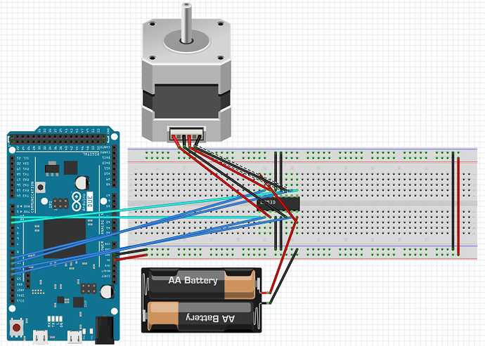

I cannot for the life of me figure out how to use a L293D with a Stepper Motor from ( Stepper motor - NEMA-17 size - 200 steps/rev, 12V 350mA : ID 324 : $14.00 : Adafruit Industries, Unique & fun DIY electronics and kits ) I have it wired as shown in the photo. I don't even know if the the code I'm using even works but whatever. All I know is nothing happens when I try anything.
Firstly you apparently haven't connected the motor supply to the L293D! The two power
strips on each side of the breadboard aren't linked. (Also you may need to check that
they don't have a break in the middle, many do).
Secondly what is the motor power supply (not 2 AA batteries as in the picture I hope).
There are plenty of example circuits using the L293D dotted around these forums and
the internet to compare against.
[ also I've just noticed you haven't connected either enable input - I think
that's necessary (they certainly need to be HIGH for any output current) ]
check your wiring. It looks like you have the motor connected to the 293 inputs and the arduino outputs connected to where the motor would connect.
Ok so I thought I had the power going to both sides but where would I hook up on the other side. And no I'm not using two AA as my power I'm using 12V. And I think I connected the enable pins and this is the code I'm using but I don't think it's correct at all.

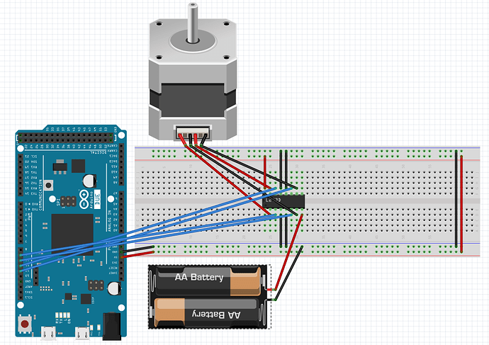

Ok so I made some changes. I changed the enables to HIGH I can't believed I missed that. I also switched the Output and Input pins and supposedly supplied power to both sides. Yet still nothing happens.

In the Fritzing I see no connection from pin 16 to the 5V logic supply. I would also suggest that you take out the serial part and try hard coding the steps variable. Get one thing working at a time.
groundfungus:
pin 20, not pin 16, this has already been pointed out.
Pin 20 on a 16 pin dip?
Quote from: groundfungus on Today at 05:52:04 pm
As groundfungus said . Also do not hook up the motor supply to pin 16.
Ok so what are the pin numbers that the stepper power supply goto? 8 and 16? And they're both positive right? Cuz the stepper power ground just goes to ground on the chip yes?
Pin 8 is for the power supply to the motor (12 volts in your case) and pin 16 is for the logic (system)supply voltage(the 5V pin on the due).
Your fritzing shows a due which is a 3.3V logic system where an UNO is 5V.
The L293D has a minimum of about 4.5V for its logic supply voltage. So it needs the 5V from the due. It should be able to see the output from the due (3.3V) as a high.
So in your first fritzing it looks like you had the power hooked up correctly but not the others.
I would first use a known program to test the stepper. Go with the example programs for steppers found in the example area of the file tab.
Kameechewa:
No. Stepper power goes to 8, logic power goes to 16.
