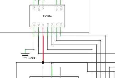

I drew this scheme of a L298n module thath is connected to an NEMA17 steppenmotor.
Altough I don't think this scheme is correct..

Are these all diode's? I thought the L298n had transistors too?

Can you post a complete schematic, including controller and its connections?
What model Arduino are you using?
Can you post link to specs of stepper, Nema17 only tells us its shape, not electrical specs.

L298N are very inefficient and if your stepper needs current control it cannot provide it.
How are you powering your project and in particular the stepper motor?

This is the exact steppen motor I use : Stappenmotor - NEMA17 - 12V 350mA
Its being powered by a 12V supply
Full scheme is also here (I could not find how to add files...)

Have you got the 5V pin of the 289 connected to 5V?
This provides power to the 289 logic circuits.
This may help;
Have you got a heatsink on the 289?

yes, everything works just fine. And the L298n does have a heatsync. But I just need the scheme for it.
Is this what you are looking for?
http://wiki.sunfounder.cc/index.php?title=Motor_Driver_Module-L298N
