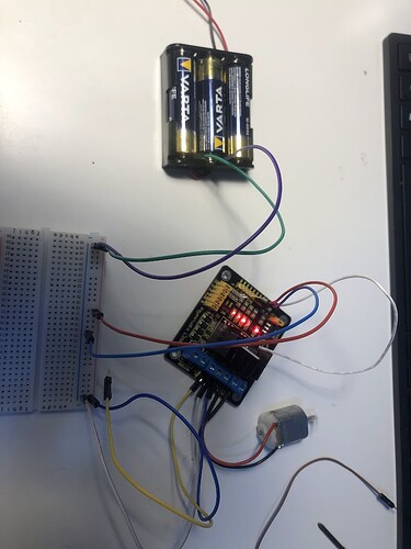

i recently bought an L298N motor driver module and i want to use it to drive 1 motor. I am using 4.5V power supply (3 x 1.5V battery) to power the motor and logic module. The problem is that the motor spins in full power regardless if EN1 is connected to Vcc or not. IN1 and IN2 still work as intended and change the direction of the motor. Is the problem that I am using too little voltage to power the module? I used 9V power source and the motor doesnt spin at all regardless of what the pins are set to.

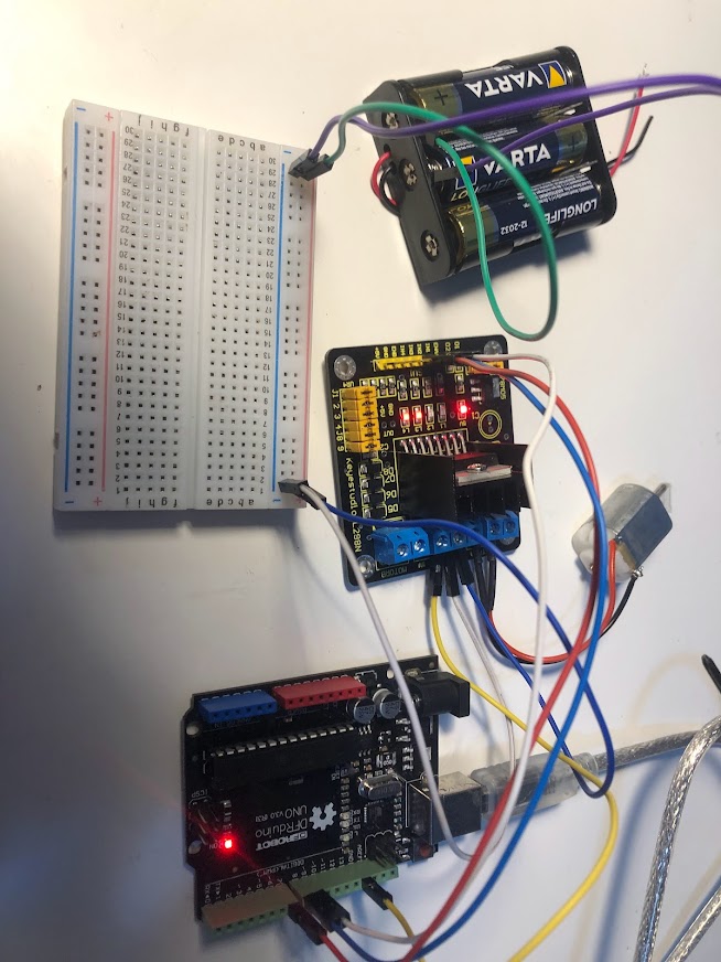

I also tried connecting the L298N to an Arduino Uno, but in this configuration the The motor only spins if only 1 of the IN pins are connected - if there are 2 connected it stops spinning.Use code tags to format code for the forum The EN1 still does not have any effect on the motor in this scenario.

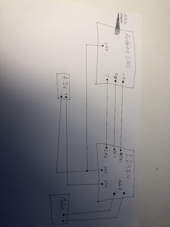

I have drawn up a diagram for the 2nd scenario where I try to sue the Arduino to control the L298N module. Excuse my drawing skills as this is my first time drawing a schematic or anything like this. I hope you can use this in reference with the image that i have given in the 1st post to help me.
Thanks a lot
Thanks, the circuit is fine.
Have you tried the modified code?
Does your motor run okay when connected directly to the motor?
You may also need to connect 5V from the UNO to 5V on the module.

Yea it runs well on 4.5V power supply. when connected to the module it also runs fine as long as in1 and in2 are connected to 4.5V also (not arduino pins, just battery).

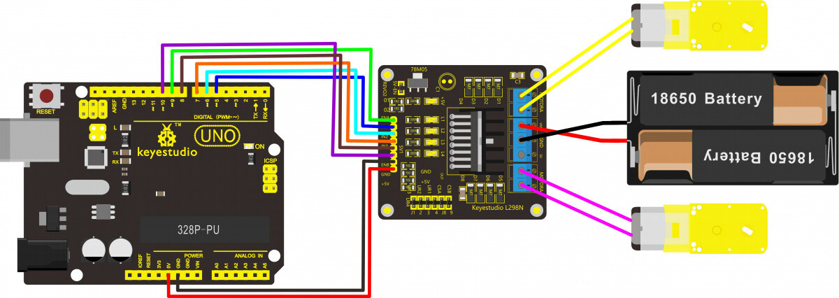

Have you tried the Keystudio sites example, even though its for two motors, it should still run one.
https://wiki.keyestudio.com/Ks0063_keyestudio_L298N_Motor_Driver_Board_Module
Note that they have also connected 5V from the UNO to the 298 module.

hey, it seems my project is working now for some reason. I think the reason that it is working is because i was using a 9V power source rather than a 4.5V one. the only connections i need are en1, in1, in2, and vcc + gnd. thanks for your help tho
