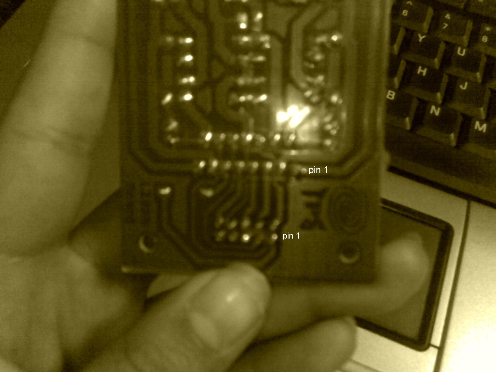

so,
i got this motor driver l298n from www.onlinetps.com..now i have a feeling its shady
and this is what i did
i connected pin 9 on the board to pin 6 on the motor driver.. since i figured it was suppose to be an enable pin
i connected pin 8 on the board to pin 5 on the motor driver
i connected pin 7 on the board to pin 7 on the motor driver..since i figured it wasn't much difference either way unless i keep one high one low
i connected the gnd pin (next to pin 13) on the board to pin 8 on the motor driver..since the motor driver apparently has a pin for it and in my understanding i need to have common gnd
i gave a 12 V supply to board
i gave 9V supply to motor driver
i connected a dc motor to the output pins labelled motor2
i waited for the motor to turn either way..needless to say it did not

Your initial hookup was quite jumbled. How is it connected now? The dual H-bridge board has the inputs paired on either side of each enable. That is, Inputs 1 and 2 go with Enable A for Motor 1, Inputs 3 and 4 go with Enable B for Motor 2.
If your motor is connected to Motor 2, you should have your Arduiino outputs connected to Motor Driver pins as follows: 9 to 4, 7 and 8 to 3 and 5 (or 5 and 3, no difference. You MUST have the grounds on the motor driver and Arduino connected. Also, I noticed that your code would run the motor at full speed for ten seconds, then try to reverse the direction without slowing or stopping. This is asking for trouble. You should take the enablePin low, change 7 and 8, then take enablePin high again, then take it low again at the end of your loop.

fried the arduino..god knows how..got a new one..started all over again..and last night 12 'o' clock it finally started working..
i'll tell you how
problem with my piece of motor driver board was that its pin-out was a jumble
i hope the attachments get posted else what i am saying will be a jumble too
i have marked the first pin of the l298 and the pin out box on the picture to make it understandable
i am sorry if the pic is of bad quality..just took it with my phone and i was dead sleepy
back to the point of how
first off i traced each pin in the pin out box to determine which pin from the l298 is it connected to it..once that was done i went to l298 datasheet to figure what each pin in the l298 does
simple mapping gave me which pin in the 10 pin out box does what
i connected the pins to pins on the arduino board giving enable - pmw pins and data - digital pins.. and it worked
i was doing the same exercise even before i posted on the forum
where i went wrong was
first at deciphering where each pin is going from the pin out box to l298
second i wasn't giving it a common ground
third i wasn't giving it 5V to run logic on the board just 9V to run motors
well this proves at least the hardware is fine.. future hitches will be attributed to human error
thank you so much for bearing with me yet helping me out
