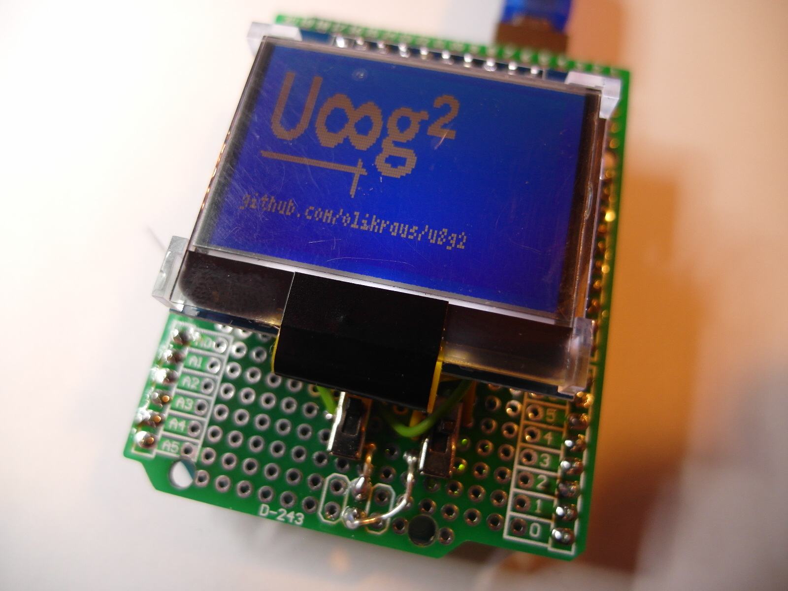

COB, COG, Display Module
Displays come in different forms
COB (chip on board) means, that the display controller is mounted on a PCB. Because PCB is already there, it usually comes with nice solder holes for wiring. KS0108 based display are a typical example for this:

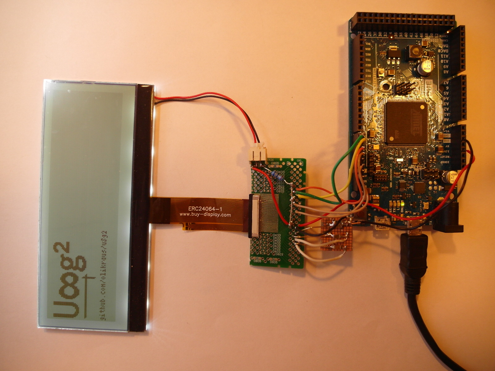

For a COG (chip on glass) the controller is mounted directly on the same glass as the display (usually below a black rubber like material). The ST7565 or the UC16xx (see picture below) controller are typical COG chips:

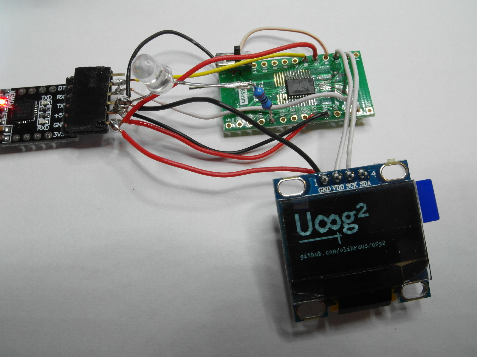

However, using such a flat flex wire is also a little bit difficult. You need a connector and some external components, which did not fit on the glass (like caps). Because of this, COG modules are also offert as a display module: The COG display comes with a PCB, which includes some additional components, the flat flex wire connection and some more user friendly solder holes or connectors. Probably the SSD1306 OLED is the most prominent example for this:
Another example are ST7565 based displays, which are often available as display module:
Instead of the flat flex wire, sometimes the COG display may also have a pin header like interface, which is easier to handle, but still requires some external components:

For prototyping, i usually use a SSD1306 OLED with I2C interface. It is simple to wire, works reliable and is cheap (at least on these internet marketplaces).
