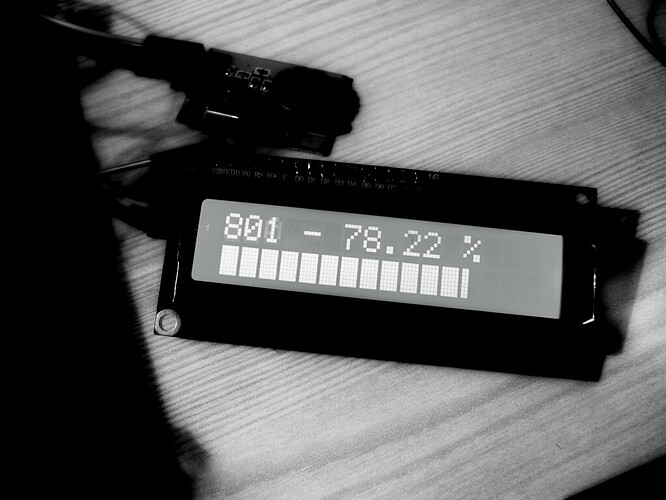

I'm trying to use the code from this blog post:
http://www.electronicsblog.net/arduino-lcd-horizontal-progress-bar-using-custom-characters/
...with an I2C LCD, using the LiquidCrystal_I2C library. I've updated the sketch to use the newer library, and have a 5K pot attached. The vertical bars display incorrectly - compare the image on the blog to mine, attached here.
What is different about the Liquid Crystal I2C library vs. the original Liquid Crystal library, that would cause this? And how do I fix it?
Jeff
