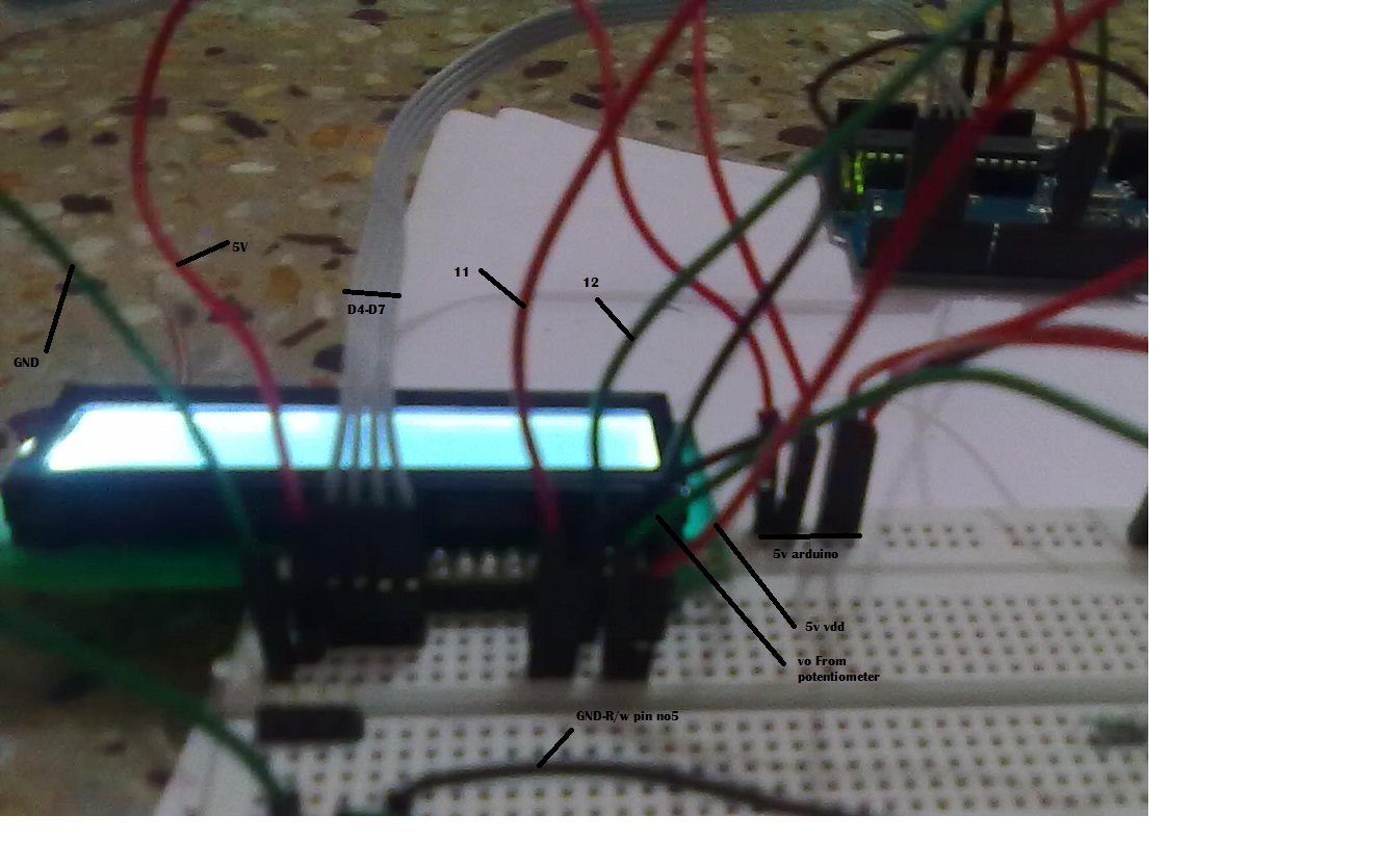

I done my wiring as per format given. I also attached with labelling.

Can you get a multimeter to measure the Contrast pin voltage ?
For the contrast voltage, the best combination of resistors for a voltage divider is a 10 k resistor connected to +5V
in series with a 1 k resistor connected to ground. The point where they connect in the middle should be 0.4 to 0.8V dc,
which should be perfect voltage for contrast pin Vo (3).
Thanks For support Being Provided . Its Started Working now
