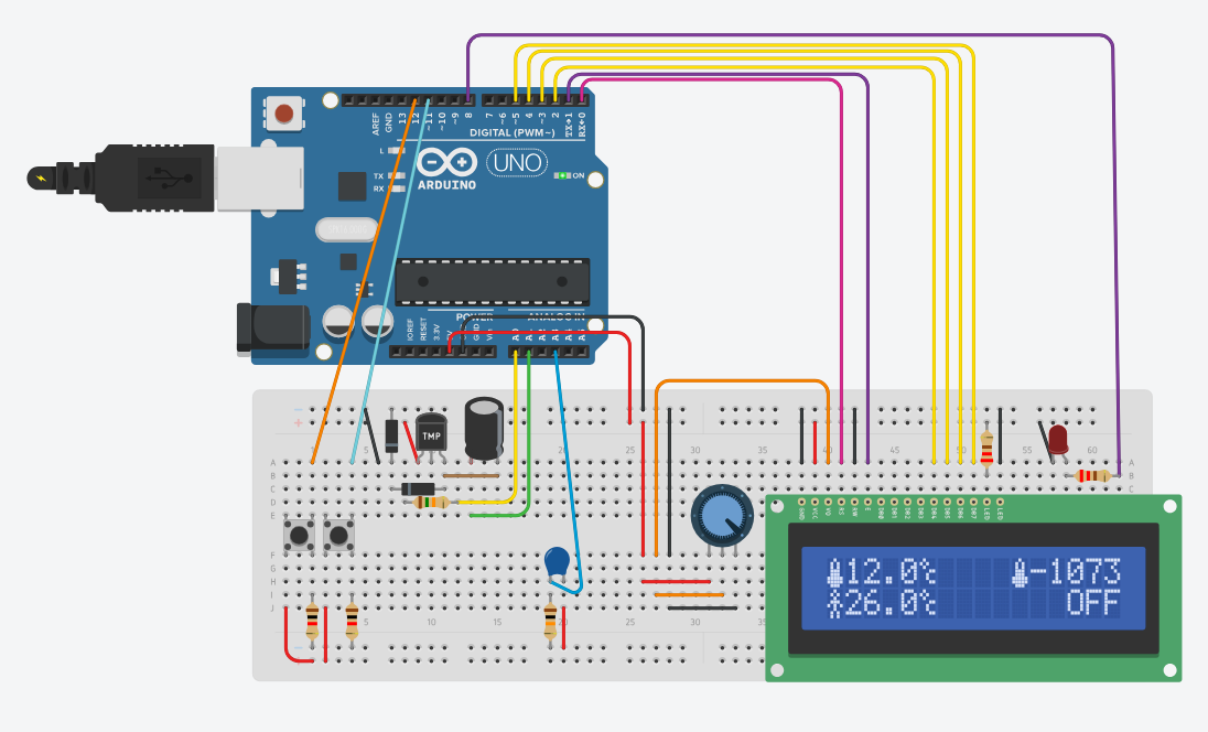

My LCD doesn't work, can you help me?

in simulation?
do this connections
could you tell me how to put a relay in this project on tinkercad? tell me the best cable and code for a relay according to the project I got from Internet. If you can also tell me if the circuit is right. telling me if all the components are needed.

No. Anyone who says they can tell you is lying or guessing. There is no way we can answer your questions.
What we can say is that is that this not the correct way to wire a relay, no matter what the intended use.
if you not able to check that the project fits all your expectation - dump it and make your own. just like this person who share this project.
start by drawing up a project requirements specification
is connecting a relay to tinkercad the complete project or are there other requirements, e.g. sensor inputs, LCD display, WiFi, Bluetooth, etc etc

I don't understand why it always remains at the same temperature values, yet if another value is read from the temperature sensor it should print that value on the display and make the LED light up.

It doesn't work because there are so many errors in your wiring. One error would stop the circuit from working correctly. You made so many errors, I lost count of them.
This circuit is too advanced for your level of experience, you must start with something simple, get that working, then add the next part and so on.
