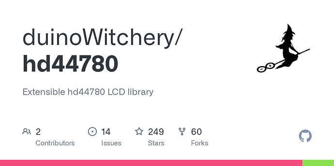

Oh, I should say try using the HD44780 library.
you might check this library and see if it works with that display.

You could use the hd44780 library hd44780_pinIO i/o class to control a hd44780 display with Arduino pins.
It will allow you to experiment with various geometries through initalization parameters to the begin() call.
The hd44780 library comes with several sketches including one that will display all the characters in the font rom.

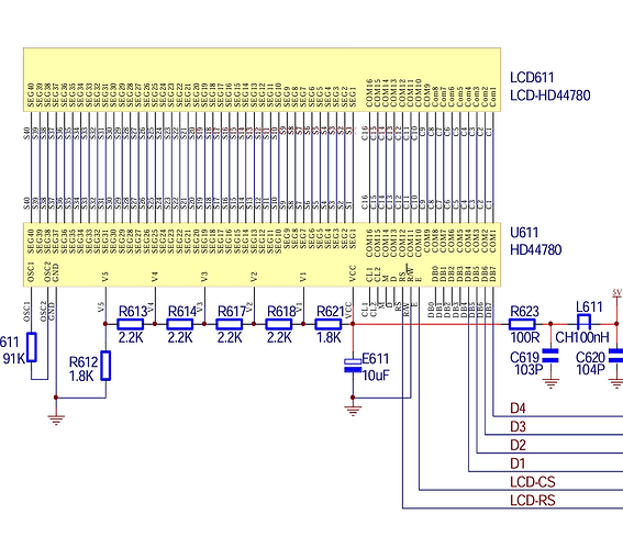

Where did you get that partial schematic?

Also, Again, where did you get the partial schematic you posted?

Why do you keep showing us this partial schematic?
It does not fully reflect your h/w, particularly if you are controlling the LCD with Arduino pins.
Where did you get it?
