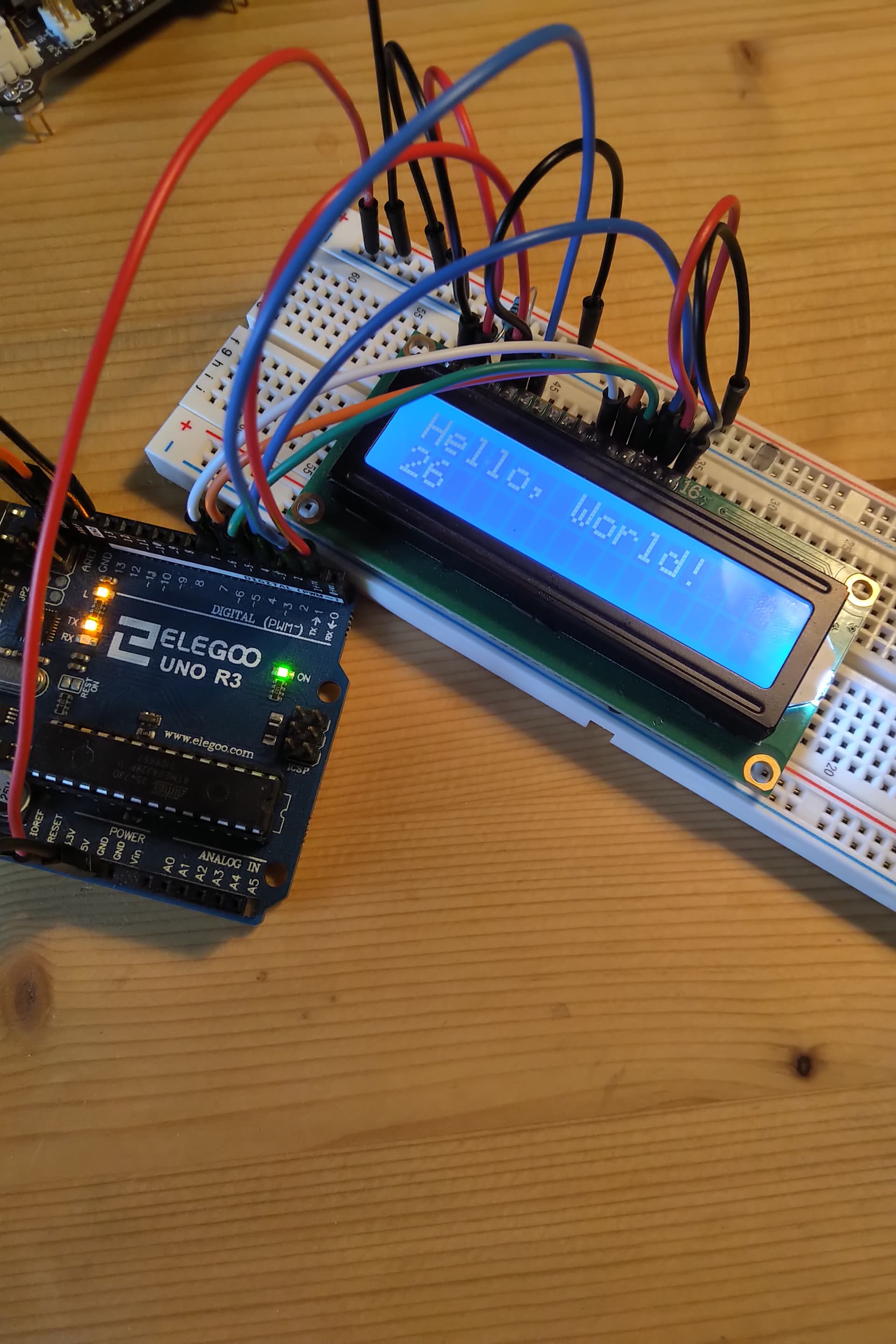

I'v a problem. If I connect the power supply of LCD Module directly to the arduino board, the test programm works fine.

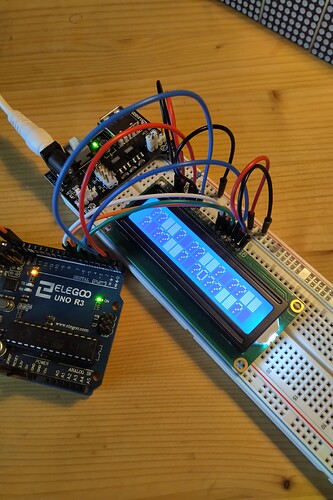

If I change the power supply of LCD to the external power module an reset the test programm, LCD only shows gibberish.
How can I fix this? Thx!

In the first pic where the GND from Arduino is connected?
Best regards.
I get the solution, thx to Paul_B. GND connection to the arduino board was missed.
