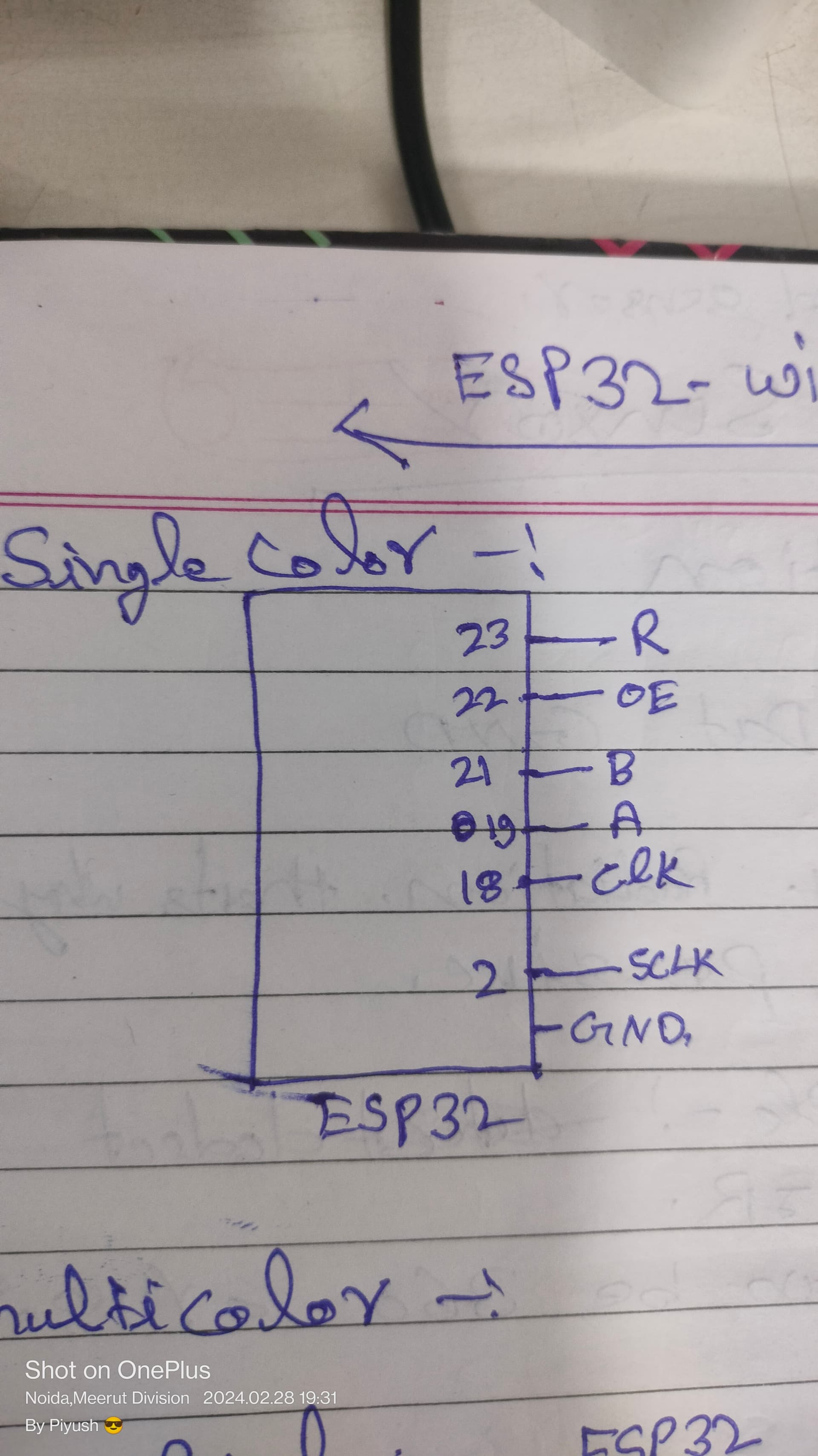

LED P10 (32x16) with esp32
i am integrating ledp10 single color matrix(32x16) using this connection
and code is an example od dmd32 library-`#include <DMD32.h>

and i found output like this -
i have checked all connection properly.
A still image doesn't say much about scrolling text. Did you try to light on a single pixel in defined x, y point? Or a line from left to right?
no i did not try any single pixel, i am using example of library, i have also tried another code ,code has been run on serial monitor but module didnt give any response, its always looks like above image.
What module did you exactly get? You hooked it up as 1/4 scan (using A and B) but it could be 1/8 scan (using A, B and C). Maybe it uses 2 color channels.
@Rintin , OP said that it is a monochrome panel. As far as I know, all monochromes are only 1/4

no it is 1/4

display is not working
It is not my code.
I found a lead to draw different-different graphic image on led matrix with arduino but still i didn`t undestand why module not workingh for esp32 while i am making all connection according dmd32 library.
