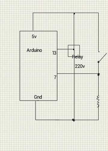

HI All,
This is my first post so forgive me if this question is answered I could not find a related topic. I have an Arduino UNO and 220v controling relay. What I am trying to do is to use the relay to turn on and off the switch. the way I have set it up is show in the attached diagram.
I am trying to use the serial connection and the input of pin 7 to drive the arduino
When I am trying to use this sketch to turn led on pin 13 it works,but as soon as I connect the relay the arduino resets.

here is the error i get when i connect the relays to the arduino
Error inside Serial.serialEvent()
java.io.IOException: Input/output error in nativeavailable
at gnu.io.RXTXPort.nativeavailable(Native Method)
at gnu.io.RXTXPort$SerialInputStream.available(RXTXPort.java:1598)
at processing.app.Serial.serialEvent(Serial.java:215)
at gnu.io.RXTXPort.sendEvent(RXTXPort.java:774)
at gnu.io.RXTXPort.eventLoop(Native Method)
at gnu.io.RXTXPort$MonitorThread.run(RXTXPort.java:1643)
I think the issue is due to the 5v running through 2 circuits. I am not sure how to solve this.
An Arduino output does not provide enough current to control a relay, and you could damage or destroy the Arduino by trying.
