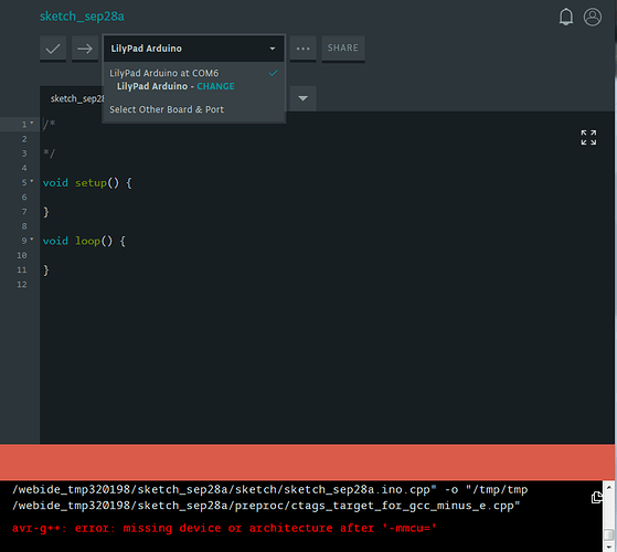

I'd like to ask for some advice on an issue with the create.arduino.cc/editor platform. I'm trying to verify a trivial sketch which works with typical Arduino platforms but with LilyPad Arduino produces the following:

avr-g++: error: missing device or architecture after '-mmcu='
Not sure why/how/where I'd modify or correct the instance where mmcu is used in these commands. Is this a broken configuration for Lilypad?
Hi, it's a known issue, we are preparing to release a new fix this afternoon. Stay tuned.
