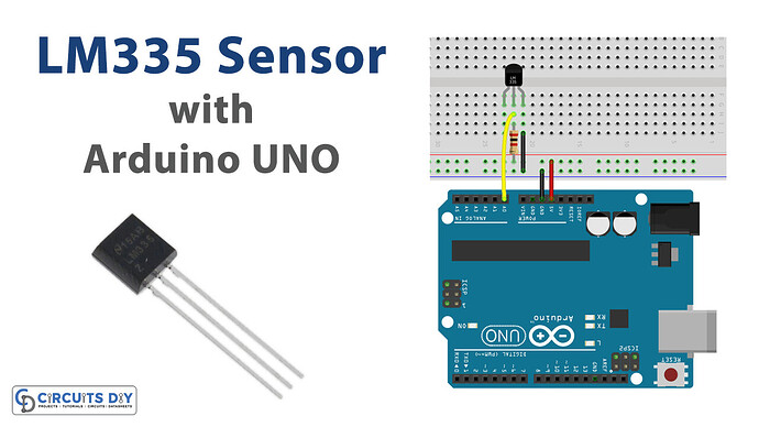

Hi, @go_yi
Have you Googled;
arduino lm335
Tom.. :grinning: :+1: :coffee: :australia:

I have but the adj pin is not connected to anything
Perhaps this is easier to understand
Its not NECESSARY but you can use the pot on the adj pin to calibrate the sensor (1 point calibration)
By calibrating the output to read correctly at one temperature the output at all temperatures is correct. Nominally the output is calibrated at 10 mV/K.
Calibrate for 2.982V at 25°C
Yeah it definitely is. For someone who doesn't understand electronics well, it can be overwhelming and also hard to filter out the useful information from the datasheet.
I don't understand this part...
But I think I can calibrate it only based on this information.
It's amazing, I thought it would be much harder at first. Thank you!
