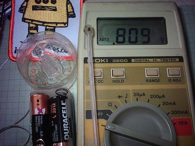

I've seen an instructable about that.
i hope it works for you.
http://www.instructables.com/id/Water-proofed-temperature-sensor/
Read it. Thanks.
My sensor reads max of 300F. I don't know what temp melting plastic reaches, or what temp hot glue reaches, because I am concerned that these temps might damage the sensor... (LM34 metal can)
I think I lean toward the (thin) plasti-kote or (thin) epoxy seal instead of the plastic sleeve. I would think the plastic pen barrel would form too much of an insulator.
