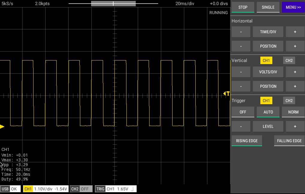

Another way, an Arduino can be programmed to produce a 50Hz square wave. Feed that to two chained op amp integrators. The first will produce a triangle wave. The second will approximate a sine wave.

Can you help me with schematic and draw a circuit of op amp?
I wrote an Arduino program that generates a 50Hz square wave:
unsigned int freq = 50;
int sqwPin = 13;
  tone(sqwPin, freq);
  freq = 50;
Here is the basic circuit. I can't vouch for the entire design, but I know it works because I built one a long time ago...
http://www.learningaboutelectronics.com/Articles/Function-generator-circuit.php
thanks. Does this circuit work with 5 volt power supply ?
I don't know, but you can always make one that runs on 5V. The basic circuit doesn't depend on any particular supply voltage. Sometimes you might need a rail to rail op amp when the supply voltage is low.
It's an idea, not a recipe. In fact you might find variations on this circuit online. I just picked the first one I found...
Ok thank you I'm trying this circuit
Why do you continuously set freq to 50? Actually, why do you call tone() repeatedly? You only need to do it once.
I wrote this code according to this post. what is the problem ?
https://www.arduino.cc/reference/en/language/functions/advanced-io/tone/
What do you mean, "according to this post"?
sorry I mean this link: https://www.arduino.cc/reference/en/language/functions/advanced-io/tone/
That's the same link. Is there something I'm supposed to hunt for there?
new code. is it ok ?
int sqwPin = 13;
  Serial.begin(9600); // Serial Port Baud = 9600 8,N,1
  tone(sqwPin, freq);
Sure, better. I would have used an int for freq and a const int for the sqwpin, though... Also I would have removed the Serial.begin().
