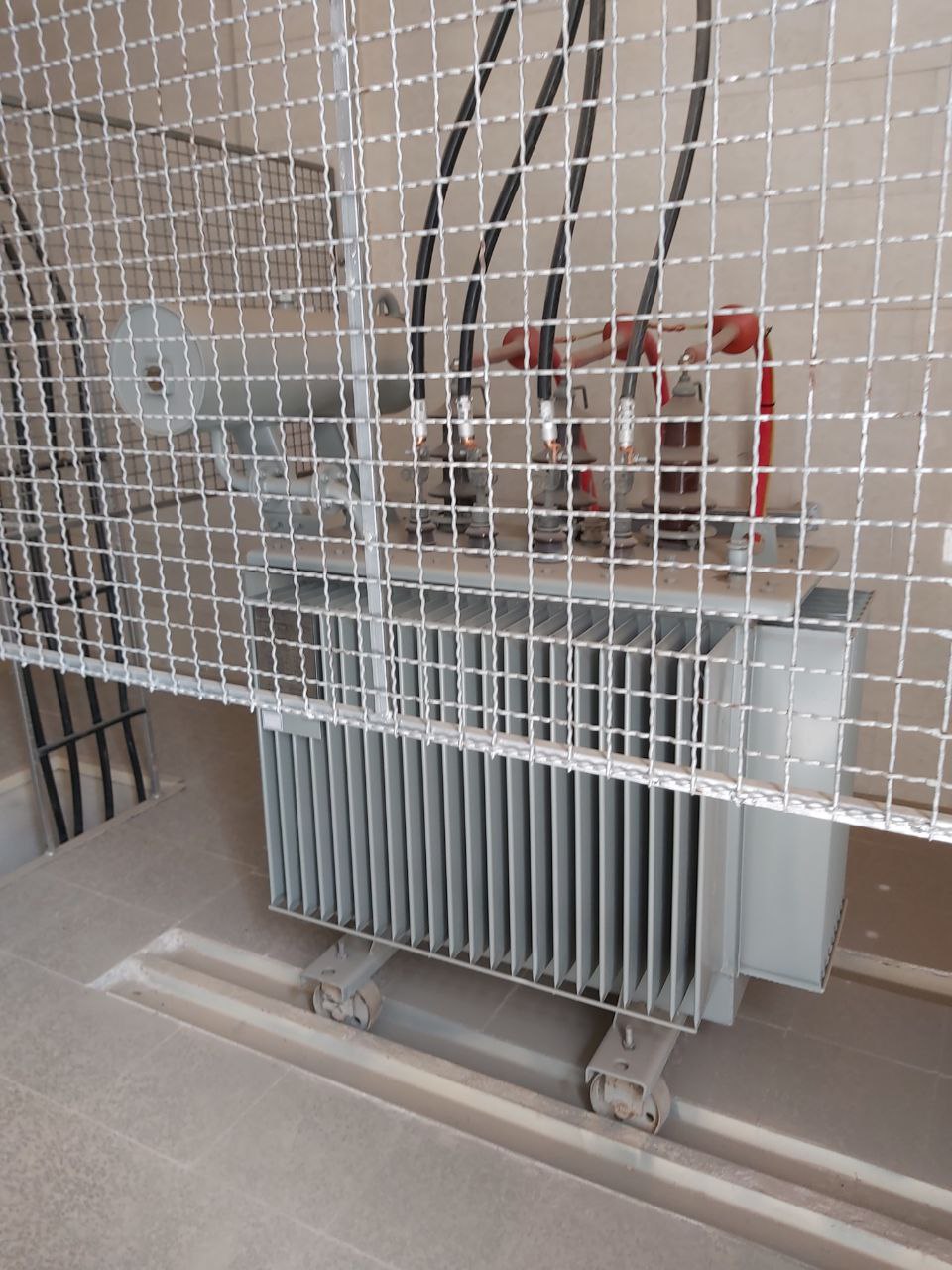

No it's 63Kv power line. I worked with 220 volts :smiley:
Professionally? Are you a certified electrician or electrical engineer?

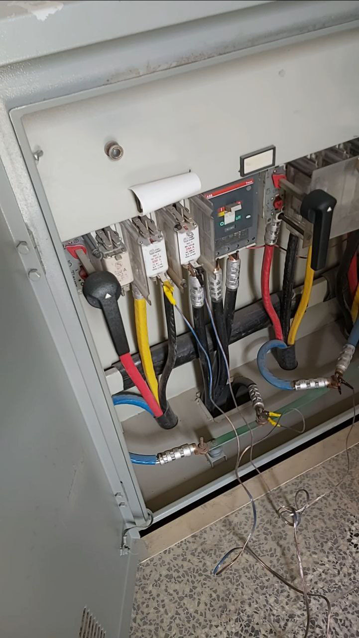

So, I built my own oscillator and tested it with AC power and found an approximate ~200 degree angle between the oscillator and AC power.
You have alligator clips and speaker wire connected to a multi KW transformer. That says it all.

How did you connect and measure these results?
Can you post a schematic please?
What is your code?
