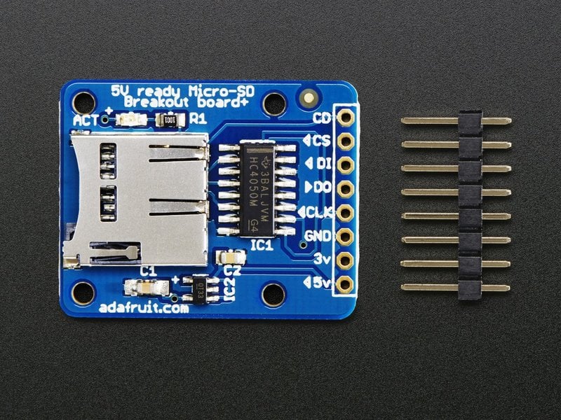

If you can read the sensor data and print it to the Serial monitor then you can also "print" it to a CSV file on an attached SD card
You do not need any extra hardware apart from an SD card module

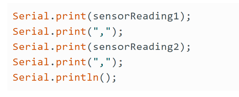

Really? Would the line be CSV.print() instead of Serial.print() . Is there a library to enable this function?
If you have an Arduino with an SD card, use the SD library to print data to a file on the card. The library docs and examples show you how.
You can also connect the Arduino to a desktop or laptop via the USB connection, and instead of using the Arduino serial monitor, use any terminal program (TerraTerm, PuTTY, etc.) to log the data to a file on the laptop.
Do you mind explaining this further? Thank you
What's to explain ?
You open a file on the SD card to write or append to. When you want to save some data you "print" the data to the file. At the appropriate time you close the file
It is your choice whether you open and close the file for each batch of data, say each line, or whether you open it at the start of the sketch and close it at a point in the sketch when data recording is complete
Job done

Here's a tutorial by Adafruit for their micro SD card breakout board:
If the file is named CSV.CSV, then yes, that is what you do record to an on-board SD card.
If you have PC to hand, you can record directly thereto, using a standard terminal like RealTerm.
You can also record directly to Excel and display graphs in real time.
The latter two options enable you to timestamp the data using the PC clock.
