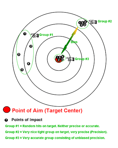

In theory, ds18b20 has sufficient precision for this if you use it's (slow) 12-bit precision mode. But precision does not mean accuracy. The claimed accuracy is only 0.5C, but perhaps further calibration can improve that. If course, you need something even more accurate to calibrate against!

As stated by others there is a big difference between precision and accuracy. You can still program to 0.1 precision but you will have to adjust your action points to offset the inaccuracy of your measurement.

I understand the difference between accuracy and precision. It's worth mentioning that this is a project for a company that I work for, and these temperature thresholds that have a 0.1 precision are what they require.
