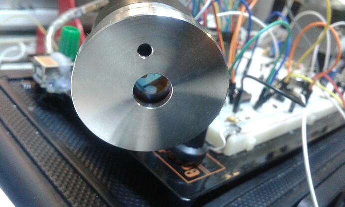

As you know, I started working for temperature sensing, with wavelengths between 0.8 and 14um. I am trying to measure the temperature of objects from afar. As an analog, I do not have difficulty in circuit design, but I will have to go a long way in software..
I have TS118-3 thermopile (8-14) I have uM different ones I have 0.8 nm ..1700nm sensors such as mrt511 AND I continue my studies I can share a few LTC6915 ADS1115 I measured in differential mode and 24 bit adcs
I will share more anolog ina188

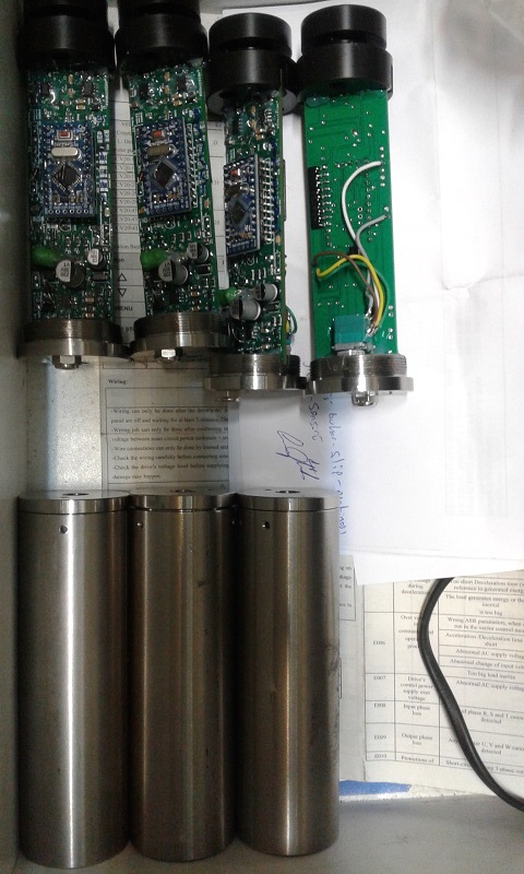

I am not an expert. We produced 20 samples of these devices to meet some needs at the factory. The design process is entirely mine. not for a commercial activity.
but if I develop it well in the future, I will consider producing it myself. There is a demand here in this sector, there are people who want from different factories.
