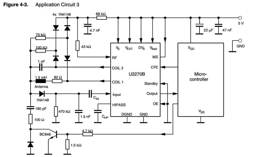

Thank you for this link. I will take a good look at this. I want to design but not like this :smiley: I am not that expert. I want to design like this:
For example, I will bought this components and I will make PCB :smiley: . I can't design the way you think. At least for now :slight_smile: . In data sheet, they didn't mention about read range and this IC is not manufactured anymore.

Yes that is not designing but simply putting together an IC with the suggested design in the data sheet. This is known as a reference design.
The problem with ICs like this is that the range is not very good as you have found out. This is because the sensitive receiver is put next to the transmitter which makes a big signal and makes the receiver deaf. So you can not get a large reading range with an all in one IC. I used to design RFID readers for a living and we never used chips like this because of exactly this problem.

I am asking again but sorry. I don't have a scope or spectrum analyzer. Is there a program like LTSPICE or Proteus that I can simulate my circuit ? I found these The UK Microwave Group - Software .
Yes you can simulate your circuit but that will not help because you are using real components with real tolerances and none ideal parameters. You need to know these in order to simulate the components you are using. For example what is the resistance / capacitance and dielectric constant of your coil. What is the inductance and dielectric constant of your capacitor.
You can get a theoretical idea of a starting point but that is where you have to start measuring things, because real components are impossible to simulate exactly, and you have to build things with real components.
A spectrum analyser is useless for this sort of work anyway and it is no good having an oscilloscope unless you know how to use it and how to interpenetrate what it shows you.
