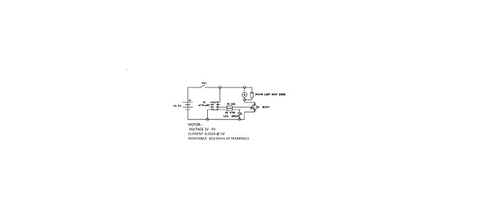

Hi. This is a re-post of the one I submitted in August last year. The reason I did not pursue it is that I got the project working perfectly. Now, however it has decided not to cooperate and I am left with the original problem of very low voltage on the output pins of a ATTINY85 microprocessor. Low, meaning, 700 millivolts or so.
I have a 5 volt supply, a LED on pin5 flashing once every 30 seconds, which it does, and pin6 is connected to the base pin of a BC547 transistor. This is supposed to switch on a small motor once every minute but there is not enough voltage coming off pin6 for this to happen. As I said, I did have it working perfectly a few weeks ago and can't understand why it won't work now. Can anyone come up with a solution please. Thank you in advance.
Enclosed is the schematic in PDF format and a copy of the sketch I am using. I am using a Arduino Uno to program it and to power it. It verifies okay and uploads okay. If I connect a wire from the 5 volt rail to pin6, the motor spins without any problem. At the end of the setup, I power the LED and motor to confirm their operation and they work okay. So I assume there is fault in the code somewhere. Sorry, but it appears that I am not allowed to include attachments for some reason.

Hi again. Thank you to the people who have responded to my post. Sorry for the lack of information, it was the end of a long frustrating day and I should have read the Forum Rules. I did try to upload the files but the site would not allow me to do so, though it appears to be working now. Anyhow, a JPEG image of the schematic has been included plus the sketch I am using.
What I know so far:-
When the sketch is run and the Setup completes, the LED flashes and the motor turns.
If I connect pin5 to the +5 volt base rail, the LED remains on until disconnected.
If I connect pin6 to the +5 volt base rail, the motor turns until disconnected.
This, to me, proves the the circuits from the pins are correct and that the problem lies with the ATTINY itself or the code.
I have tried the motor circuit on different pins, altering the pin assignments to suit, and have the same result.
I have also tried different ATTINY'S with the same result further suggesting that the problem lies within the code.
Before Christmas, I had the project working perfectly for 3 weeks continuously using the same code.
Motor information. Voltage 3V - 5V
current 0.016A @ 5V
Resistance across the terminals 30.6 Ohms
If any more information is required, i will do my best to provide it.
Thank you again for your help.

If you do not have the required current-limiting base resistor, 700 mV is the expected result.
Don't expect the ATtiny to survive such abuse. Use a suitable base resistor instead.
