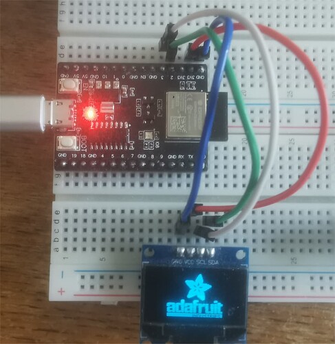

Make ESP32 C3 Super mini work with OLED displays
Hi!
I'm trying to get my ESP32 C3 Super mini to work with my OLED displays but I just can't get it to work.
For instance: I'm using Arduino IDE and I have managed to make the displays work (your classical I2C-SSD1306 and even some SH1107) with my ESP32 and my ESP32 S2 Mini.
I'm just using the example from SSD1306's library example called ssd1306_128x64_i2c.ino and the only change I have made "to the code" was just changing the #include <User_Setup.h> to #include <"SetupForSomeDisplay.h"> to then change on that ".h" the pinout.
The pinouts I actually have is:

Please, post the OLED sketch that was working with ESP32 S2 Mini.

on a ESP32-C3-MINI-1 I used SCK pin 3 and SDA pin 2, e.g.
driving a ssd1306_128x64_i2c

  Wire.begin(2,3);

THANK SO MUCH!!!
It works perfectly and by just copying the code. Now I'm wondering what difference does your code have in comparison with Adafruit_SSD1306/examples/ssd1306_128x32_i2c/ssd1306_128x32_i2c.ino at master · adafruit/Adafruit_SSD1306 · GitHub which does not work.
probably the call to Wire.begin() which defines the I2C pins as 2 and 3
oid setup() {
  Wire.begin(2,3);
otherwise it probably uses some ESP32 default such as 22 and 21
Oooh, I see! Thanks a lot for the help :"D

  Wire.begin(2, 3);
