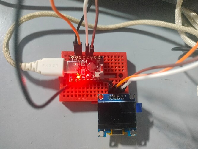

ESP32C3 Super Mini not working with OLED SSD1306
The display is working fine with a arduino nano i used adafruit display code.
For this ESP32 c3 super mini i used code i saw on this forum experiencing the same issue but the code worked for them but not for me : ( pretty new to this stuff thanks.
Here is the code that I used

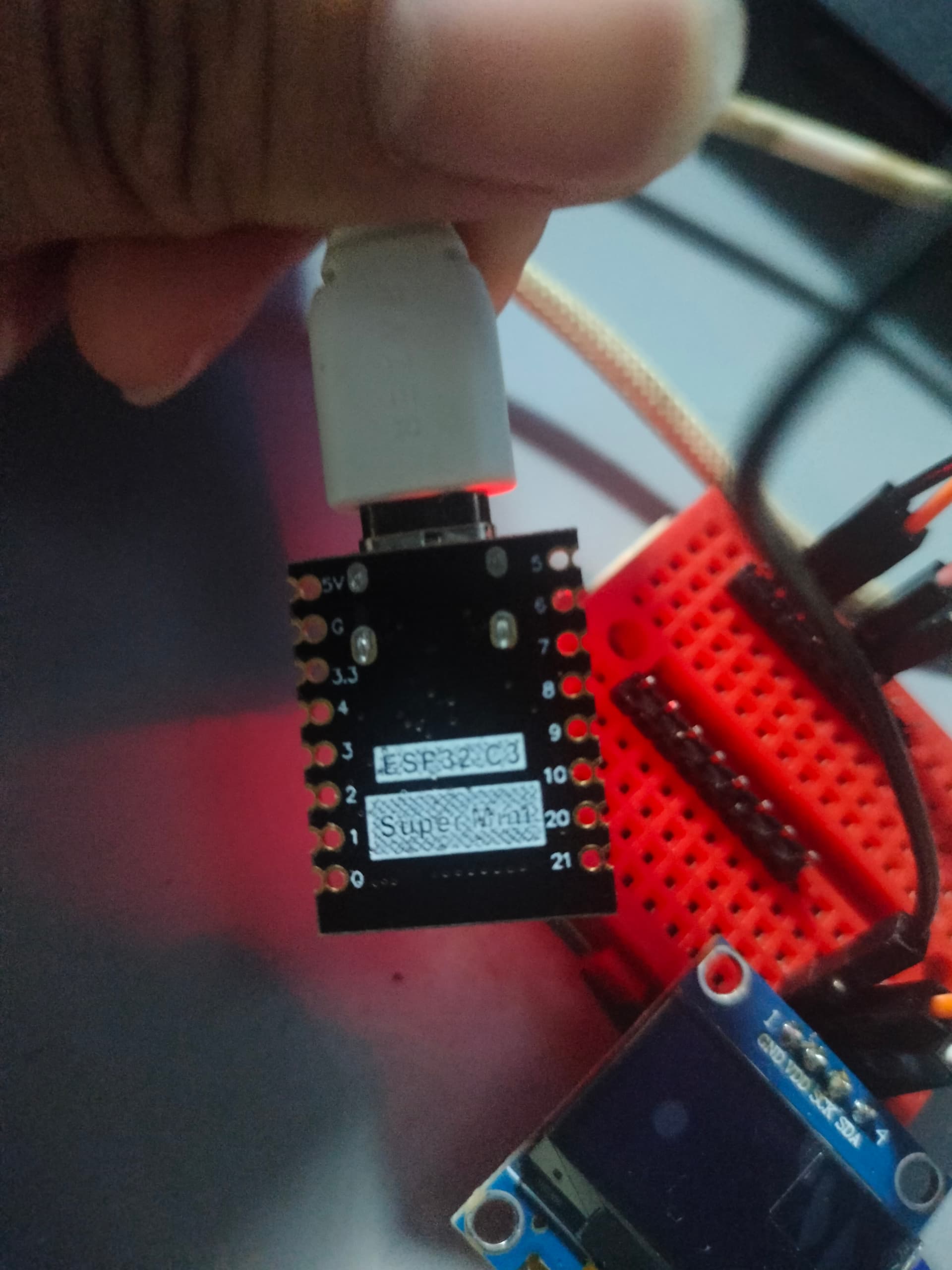

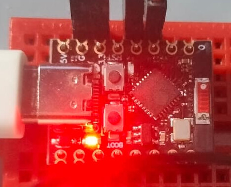

And there's the reason why it's not working. You haven't soldered the headers to the ESP32 board. So there's no reliable connection, if any.
You must solder the headers.
No, there is no other way.
@van_der_decken is correct and they need to be soldered properly.
Soldering Advice:
It looks like the fault is a bad or missing solder joint. Gather a few scrap circuit boards and practice your soldering technique:
  • Heat: Make sure the iron is hot enough for the solder to flow and wet the joint.
  • Control: Apply just enough solder to form a smooth, shiny fillet—no blobs or cold joints.
  • Practice: Use the scrap boards to experiment and build confidence without endangering valuable parts.
A little practice now will make future repairs quicker and more reliable.
Soldering Tips:
  1. Use the Right Solder: I prefer 60/40 solder with a Rosin core flux because it’s easier to work with. For more information on different types of solder, you can check out this guide: Types of Solder.
  2. Temperature Control Matters: Soldering is a basic skill in electronics, and mastering it is crucial if you plan to continue in this field. While inexpensive irons can melt solder, they often lack the precision needed for good results. Investing in a soldering workstation with temperature control is ideal.
  3. Practice Makes Perfect: Practice on old circuit boards to build your skills without risking damage to your current projects.
  4. Lead-Free Solder Considerations: Note that lead-free solders require higher temperatures, and some older soldering irons may not reach the necessary heat. Ensure your equipment is up to the task.
For additional soldering resources, you can explore this guide: Learning Soldering for Arduino Projects.
Besides the soldering problem, there's another one. On the supermini, SDA and SCL pins are 8 and 9.
