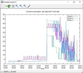

using SCT-013 clamps with the ESP32 I use a ESP32-4-Channel-Mains-Current-Sensor
e.g. measuring house current

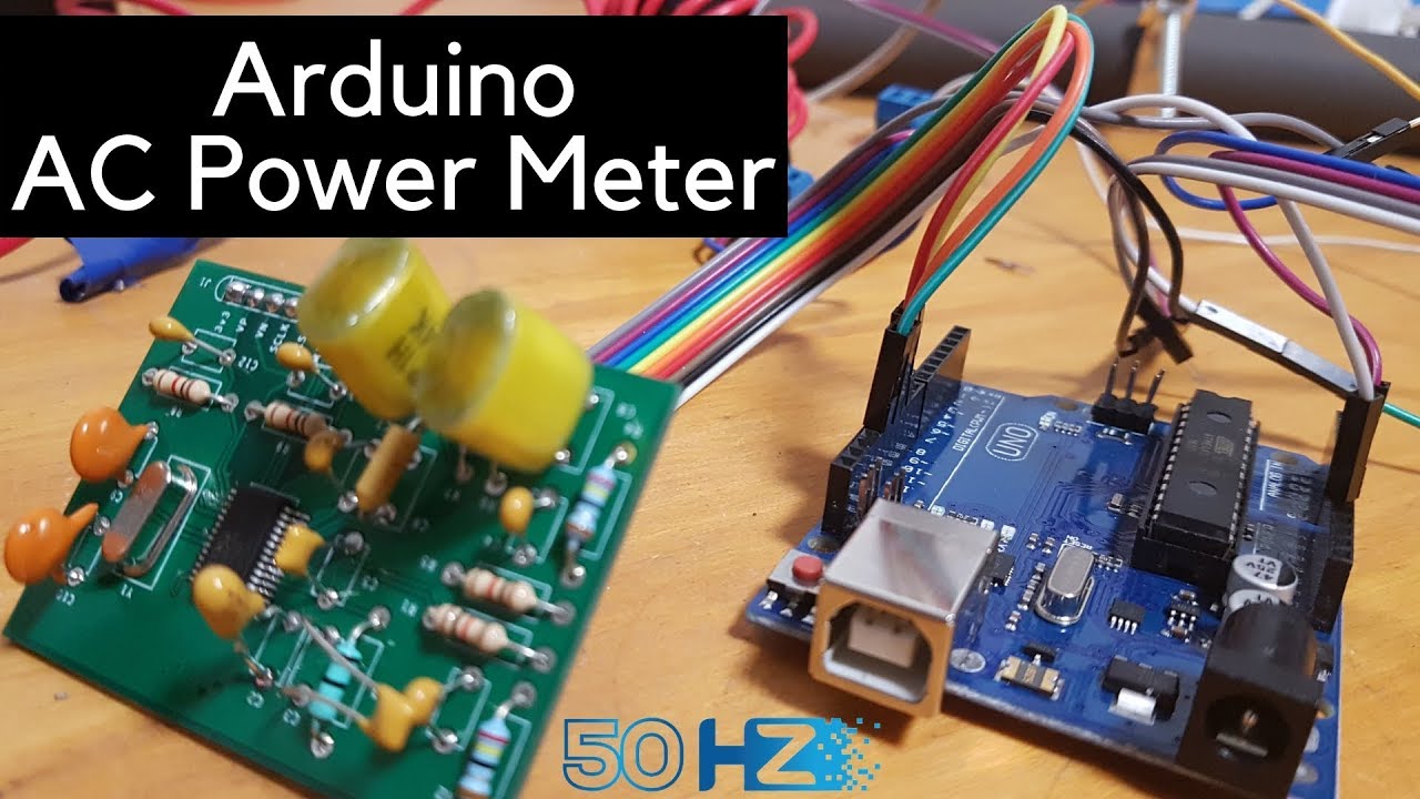

This YouTube channel may be of great help.
