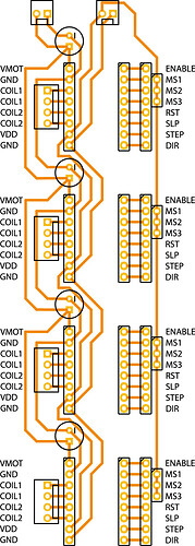

I'm working on a project, a scaled-up version of an older project. It has a lot in common with CNC-machines, this one has less power and is designed to handle different painting tools (airbrush, markers, brushes and such).
I decided to build this one in a more proper manner and i am planning to make a PCB for the stepper drivers Polulu stepper drivers (A4988). Design below.
I'm not really sure if this is OK, is the wiring of the decoupling capacitors ok like this? Or should i use one capacitor which is rated for decoupling all four?
Other question (this is the first time making a PCB); when exposing the PCB its the UV light that counts right? Did anyone try exposing with the lamps for exposing screens (in screen printing), if yes, is there any advise on the amount of units or length?

The VMOT is 12V from an old PSU, the VCC from an Arduino Mega
No such thing.
Each unit requires its own decoupling capacitor.

Use wider traces for all power and high-current lines, you need low inductance and low
resistance, especially on the motor and motor power traces.
I think the Pololu modules have some decoupling on them, I'd add more on the motherboard
anyway for Vmot, in the 47uF to 330uF range to reduce noise going out the the rest of the system
