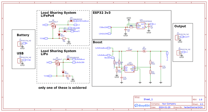

First Ideas
Load sharing systems have been used quite often lately, but I havent seen them working with two battery types.
The idea is that once USB is connected, the gate of a p channel mosfet turns off the connection between the battery and the load.
I opt for two load sharing circuits while soldering only the one for the specific battery, not knowing if that would really work. There are also some solder bridges in the circuit to take that part completly off everything depending of the battery chosen.
I would really appreciate if someone could look at my circuit and tell me if that makes any sense / could work, or if I should do something different.
It might work, but I'm not sure it's a good idea.
You may find (as I did when testing ESP8266 modules) that a significantly higher current is drawn at voltages higher than the intended 3.3V, which will reduce your battery life. Using a 3.3V LDO regulator, the circuit may draw less current overall, even taking into account the regulator's quiescent current.
Hopefully you are already aware that not all LDO regulators are the same and some have a much higher drop out than others, but they are still called "low drop out". Quiescent current can also be significantly higher in some than others, so check the regulator specs in the data sheet carefully. For example, AMS1115 and MCP1700 are both described as "low drop out" but if you check the actual drop out and quiescent current from the data sheets, you will see how much difference there is.
Myself, I would get the breadboard out and test both the options.
There are a few things that a straightfoward 'is my design OK' question might not pick up.
As well as the issues mentioned by @PaulRB, there is the problem with the high current pulses consumed by an ESP32 when WiFi or Bluetooth is used causing resets, some regulators cannot cope with them.
And then when presumably the PCB is completed you might find the sleep current is a lot higher than wanted.

With a LiFePo4 battery it will be hard to use a 3.3V regulator on its own. Already at 80% state of charge, it will have a voltag of 3.3V and the regulator will not work anymore. So I would have to boost the LiFePo4 to 5V and then regulate it to 3.3 with the LDO or use a SEPIC circuit. Connecting it to the ESP32 directly seems like the better option for me
The one I used in the schematics has a dropout voltage of 238 mV max, typically around 150. That is as low as I could find and good for a LiPo, but not the LiFePo4. They always need to have a higher input (+ dropout voltage) than the output and that does not work very well with the LiFePo4 voltage range.

Is that specific to my circuit or a general point? The LDO would be only used with the LiPo. And the LDO I chose is commonly used with LiPos and should be fine.
The LiFePo4, will be directly connected to the 3.3V input pin, it should not have too many problems with the steady output at current spikes.

The regulator will not stop working. But it's output voltage will drop below 3.3V. I have noticed that my ESP8266 circuits continue to operate ok until the discharge protection circuit for the Li-po/li-ion batteries cuts off at around 2.8V. So the ESP is probably working down to maybe 2.6V output from the LDO.
That would be much less efficient. Boost converters have high quiescent current and maybe only 80%~90% efficient. After that, the LDO will waste much of the power reducing it back to 3.3V because it will be only be ~66% efficient.

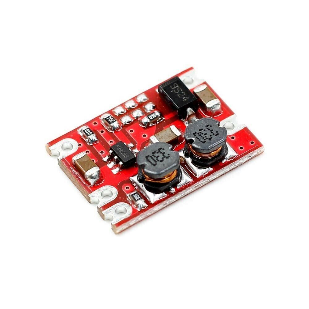

Maybe look for a boost/buck module that will produce 3.3V output over an input range of around 2.5V to 5.5V. For example
The DC-DC power module is automatically raised or lower to support the shutdown function. The maximum input voltage is 15 VDC, the quiescent current is less than 200uA.
The fixed output is 3.3V / 5V /12V and the maximum output current is 0.17 A.
Work frequency is up to 1.2MHZ, high stability, cost-effective, all industrial-grade components, long working voltage drift-free, suitable for demanding applications, mass production.
On drop down menu can choose what output you need: (Please pay attention what is on packaging numbers show what is the output voltage)
  • 3.3V -X12909
  • 4.2V -X13011
  • 5V -X 12910
  • 9V -X13012
  • 12V -X13013

So far I have read that it is not recommended to use an LDO with lower input than output voltage, since the behaviour could be "unexpeceted"
But why? Why use a converter at all if you can just connect the LiFePo4 to the ESP directly?
And using an external module would not be very pleasing when designing a PCB.
So since the question is how it is possible to have solder places for the two battery types on the PCB but using only one: is your recommendation to not use the circuit shown in my schematic but instead of the 3.3V LDO use a buck/boost circuit that puts out 3.3V?
I would see the disadvantage here that the LDO is only really usefull if the PCB is using a LiPo, with the LiFePo4 the circuit needs (in my opinion) to connect the battery directly and not through a LDO or buck/boost circuit with energy loss

Battery protection is maybe the biggest issue: they have a different minimum voltage, at which your circuit should cut out. If that cut-off is set to LiPo level, your LiFePO4 isn't of much use; and if set at LiFePO4 level you would destroy your LiPo battery. Unless you rely on battery protection circuits built in the cells itself.

If your regulator can do 500 mA peaks you'll be fine. The rest of the peak can be handled by the decoupling cap.
When running motors I'd get a lot less worried about shaving off a few µA of quiescent current...
Those do need a boost circuit; those are indeed notorious for high quiescent current. Look at a boost circuit with an enable input, or a way to switch them off (probably needs a high side switch on the power input of the booster).
