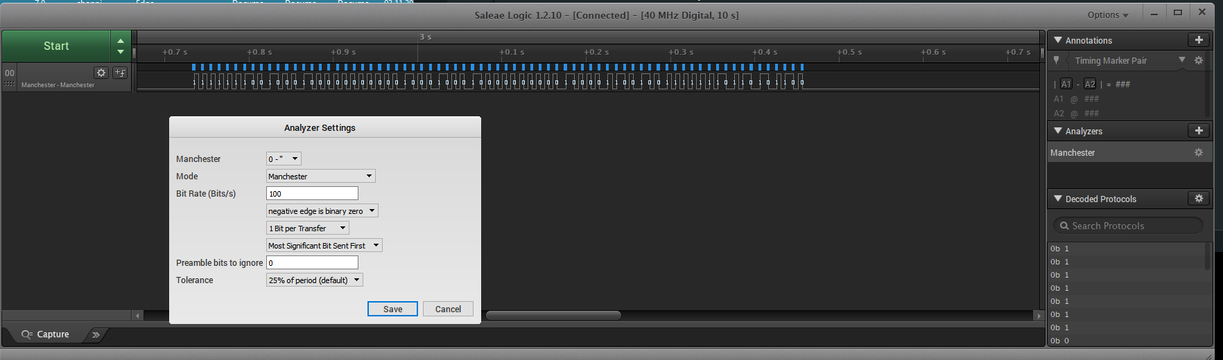

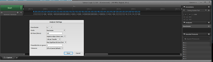

Your transmitter program looks OK according to my logic analyser:
I just reformatted it slightly :
