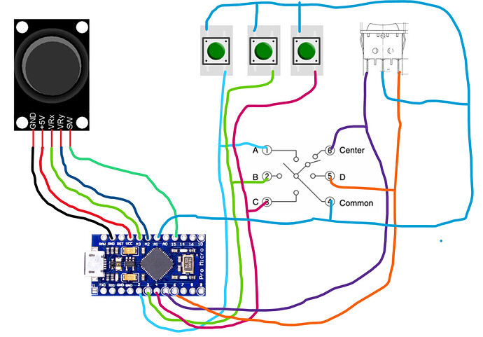

It might be pretty clear what you think you're doing, and if so, the following comments are appropriate, but we'll never know because there's too much ambiguity. So, chew on the following.
  1. your 5-way switch defines one common pin(row), and 5 'columns'. Fine. Now, you have five other contacts (three buttons, two sides of an SPDT). Fine, wire one side of each button, and the common of the SPDT, together. That's a second 'row'.
    That pot/pot/button needs separate wiring.
  2. where's the second side of the switch, for wiring to your 'matrix'? It's either 5V or gnd, so it can't be wired to a matrix.
  3. the two pot signals need to go to individual analog inputs (A0, A1?), so they can be read unambiguously. So do it that way.
    Total I/O - 5x2 for matrix, one DI for the button on the joy, and two AI for the joystick values.
    There may be ways to merge some of this mess, but I'd go for simple and wire it like that.
    In future, please do as others are suggesting, and provide a better schematic, as well as better information about the devices.
    Caveat - my crystal ball is old, cracked, dusty, and the magic has leaked out, so if I've misinterpreted some of your info, attribute it to that; I did the best with what you provided.

And in the meantime, you posted another drawing that demonstrates the situation is worse than I thought.
  1. use the 5V output from the mini for the joystick.
  2. the SW output from the joystick needs it's own DI
  3. the buttons, and the SPDT, need their own common; the other sides of those 4 devices get wired to the 5 contacts of the 5-way.
  4. the two analog signals from the joystick go to A0 and A1
    C
  1. How come the pot/pot/button can't be included on in the matrix? I saw somewhere that the matrix does not need to be complete.
  2. I do not understand, why you I need to provide gnd of 5V to a switch in this case.
  3. that makes sense, but what about the switch on the joystick? I should be able to include that into the matrix.
I am going to work on a new schematic using your comments. I will post when I am done.
  1. your 5-way switch has 5 contact outputs and one common pin.
  2. your joystick has 5V, ground, pot output x2, and button x 1 - where's the second connection for the switch, which is needed if the switch is to be incorporated in a matrix?
You gave a link for your five-way, but clearly the joystick isn't fully understood. if you think you can include it in a matrix.

You may need to research matrix scanning a bit more, so you understand my comment. That joystick button must have, as it's second pin, an internal connection to 5V or GND, or possibly to one, the other, or both pot signals, though I've never seen that done, nor can I imagine why it would be done. But a spec sheet would illuminate..

Here is an updated picture. I am a little confused on this...
Why would each of the buttons and SPDT need their own common? I believe the picture is shown as a 1x5 matrix now.
If you have a 1x5 or a 1x(anything) matrix, it's not a matrix. You might as well ground the "1x" and just read the 5.
I think I see the error Camsysca mentioned. Your wiring shows no difference between a green button press and a rotary switch selection. Also if you have any constantly on contacts in a matrix, it will interfere with other switches in the matrix, unless diodes are used.
Supposing the rotary switch is set to "A". That connects "Common" with "1", which is a direct short across the first green button.

A 1x5 matrix has a common pin for 5 of the buttons; a 2x 5 matrix has two such arrangements, where the second 5 connections are the same as the first 5, but a second common links that 5 switches.
Technically you can have a 1x5 matrix, sure. But the interface does not require scanning in software. That is what I was trying to get across.

I do understand that a 1x5 matrix... and I thought I needed a 2x5 because of the joystick. But now that I understand the joystick better, I understand a 2x is not needed.
This is also something I read about. But I am only concerned about the 5way being an issue with this. This is primarily a thumb button box, so unless you have 2 thumbs on one hand you would only be pressing one button at a time. The 5 way is a little different because you could want to press left, but you could also bump into the down and pressing down. (3 selections when only 1 was desired)
