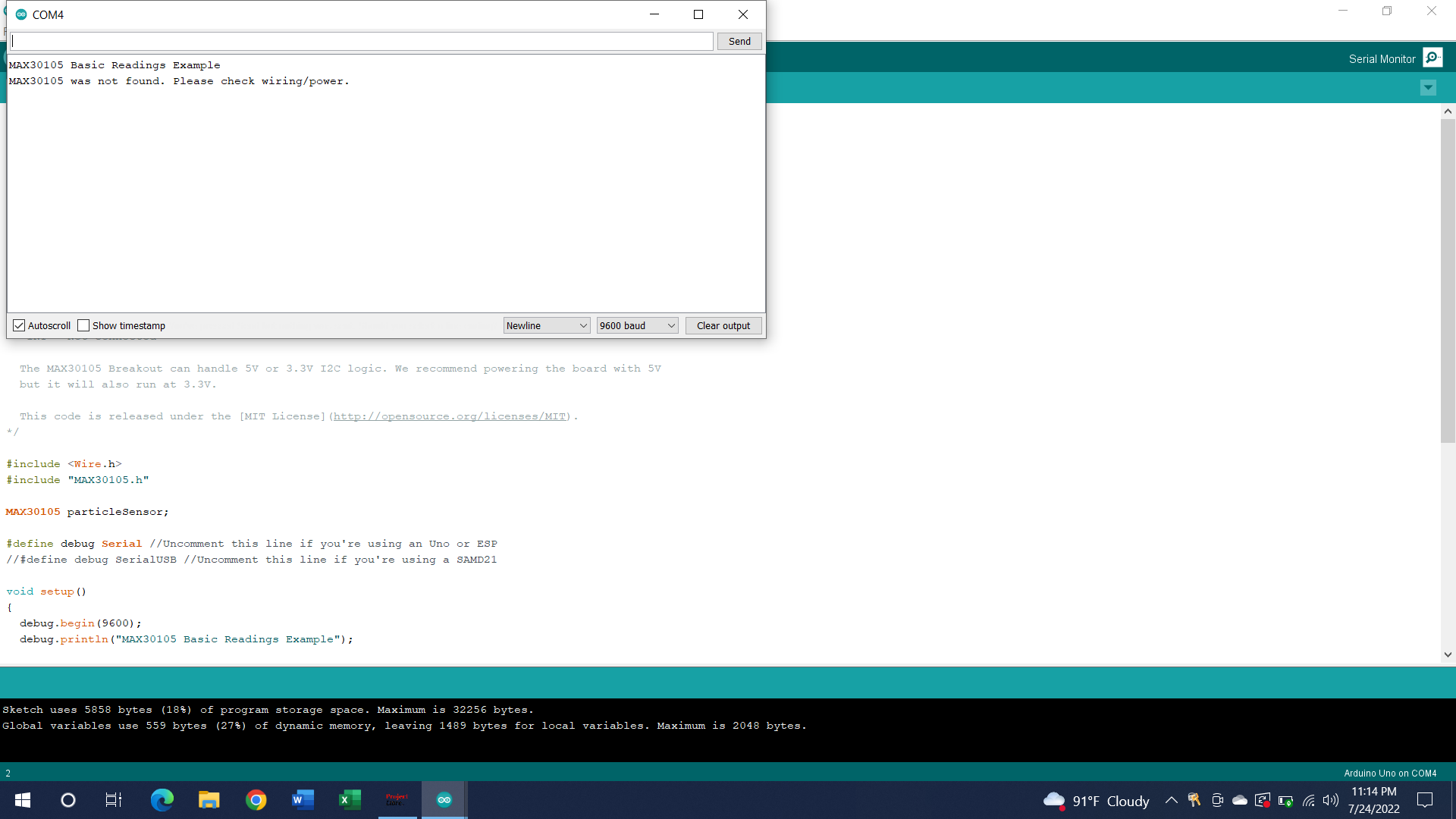

Whenever I try to run the code, the red light for the sensor does not turn on and I receive these messages in the serial monitor.
"Initializing..."
"Basic Readings Example"
"MAX30102 not found. Please check wiring/power."
I recognize that the code gets stuck within the first few lines of the void setup, but I don't understand why.

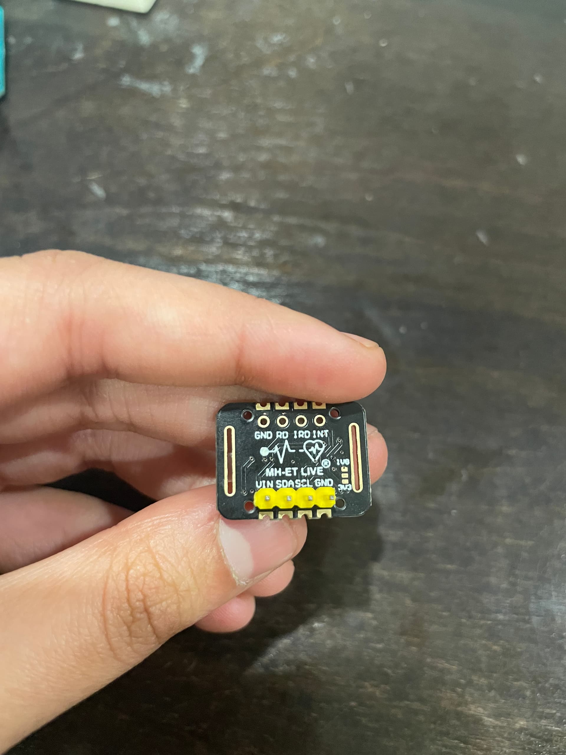

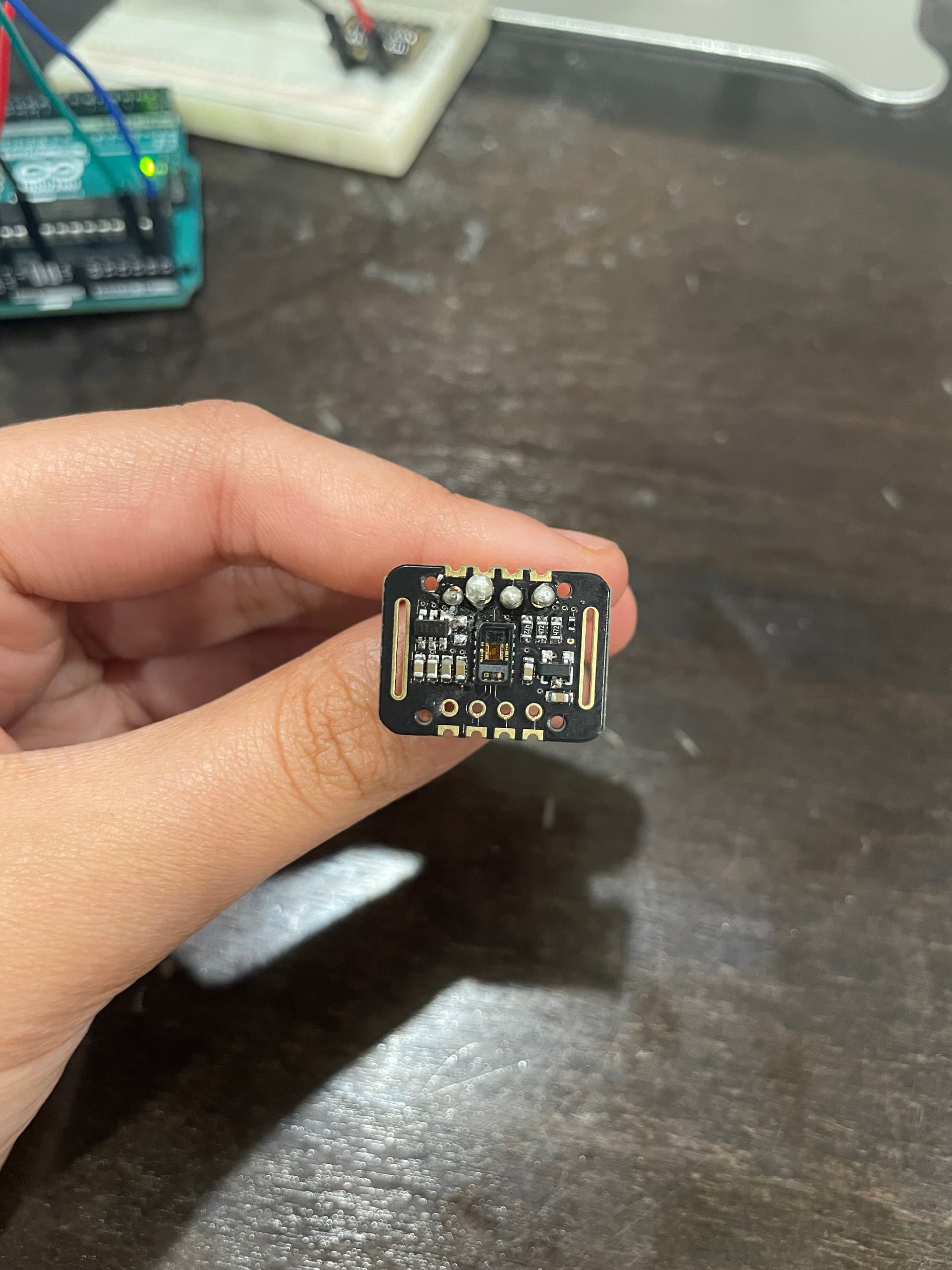

I was tried soldering some of the pins, to see if that would help the connection issue. I also swapped my Arduino Uno to see if it was a problem with the board. Additionally, in speculation that I may have ruined the sensor in my poor attempts to solder it, I replaced the soldered sensor with a new unsoldered one. I also replaced my USB cable, however, all these attempts were to no avail and there is still no sign of activity from the sensor. A few weeks ago, I did wiggle around the Power and SCL jumper wires connected to the sensor and saw the LED flicker briefly, but haven't seen it since. I used my multimeter to check the voltage of the jumper wires on the Arduino, the pins on the sensor, and the jumper wires connecting to the sensor but all read the same at all three locations.

Here are some more pictures if this may help:
Please excuse my poor job of soldering - prime example of a skill that is easier said than done ....
I have read about how there are issues with the MAX30100 due to the placement and connections of the pull up resistors within the board, that requires one to rewire the circuit for it to work. I ruled this out as a source of error, since I am using the newer MAX30102 version, but I am including this information here for the sake of thoroughness.

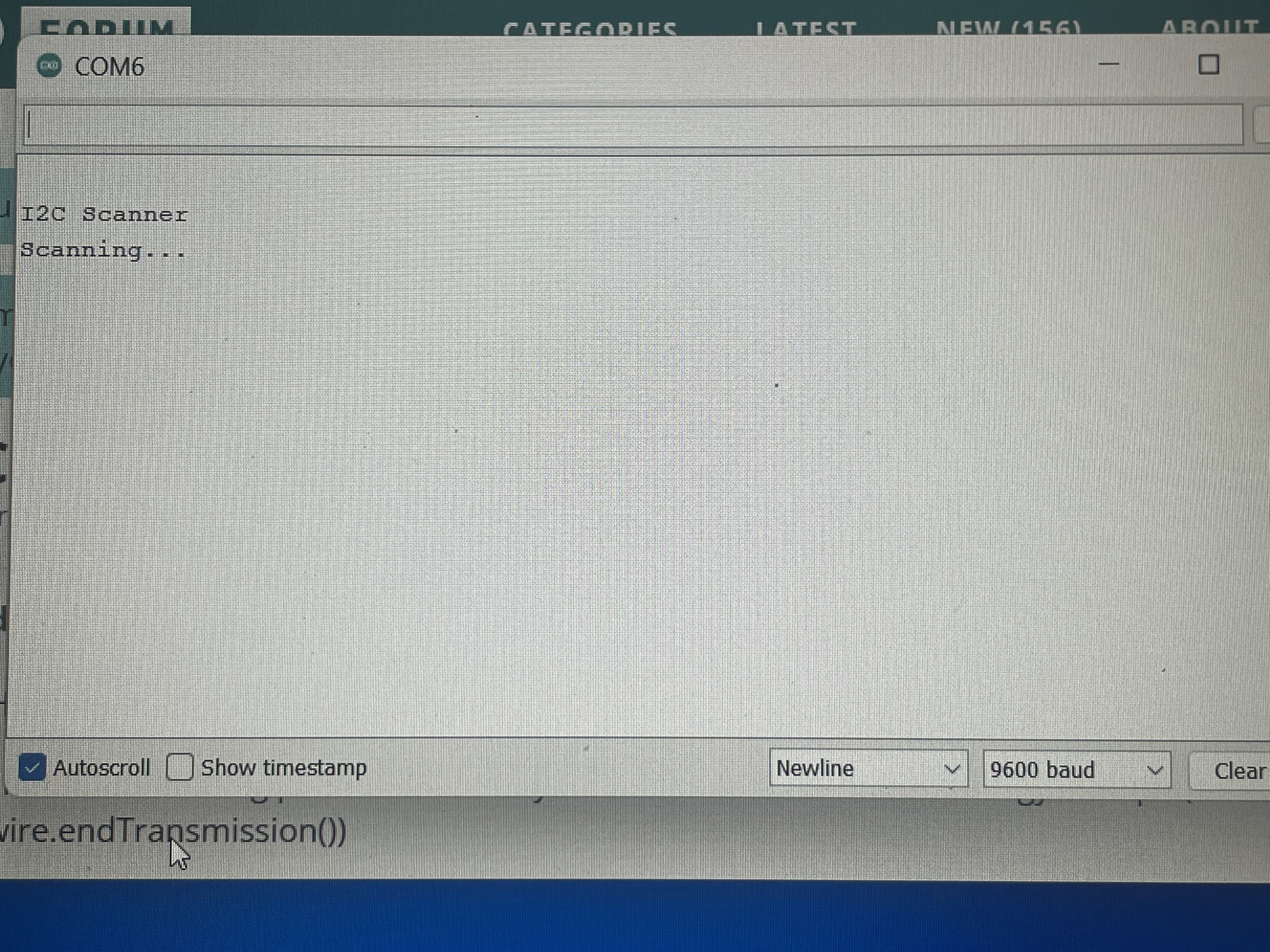

I changed the connections for the SDA and SCL then tested the I2C Scanner for my soldered sensor and received the following messages.
When I changed the power connection to 3.3 V, I saw the full message.
On the other hand, when the power was connected to 5V then the message was stuck at "Scanning..."
This pattern was repeated when I changed the connections back to A4 and A5 as I had originally, just to see if there would be any noticeable effect.
I also tested the I2C Scanner on the unsoldered sensor and saw the full message at both measures for power (3.3V and 5V) and for both connections (A4 & A5, and SDA & SCL)
I'm not sure if this discrepancy sheds any significant light on the issue, but I just wanted to note down my observations
