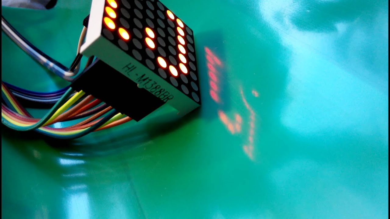

Hi guys,
I just received my 8x8 LED matrix with MAX7219CNG +1508, and... an HL-M1388BR on it. I bought it on amazon. I got totally mad this evening trying to understand why this was happening. As I'm not very experimented in electronics (I'm more of an IT guy), I thought I did something wrong and was about to post a new topic on the forum after 3 hours on searching the Internet when I stumbled upon this post.
Here is my simple wiring,
could you please check that I'm doing right, I'm still not very sure... Here is the code I used to test: LCDemoMatrix.ino from Arduino tutorial: LED Matrix red 8x8 64 Led driven by MAX7219 (or MAX7221) and Arduino Uno - YouTube and I also tried the version of LedControl from the 13 march 2015, in case it was the new version that had a bug.
Could you guys please confirm me that I did well and should contact the vendor for a replacement?
As you can see on the photo, all leds are fully bright, but sometimes some rows are dimmer than others, reacting somehow to the commands sent by the program, but it is actually not the expected result.

So he sent you another "B" instead of an "A"? This is an absolute scream because it means he is supplying not just one or two, but all of them incorrectly. Anyone who does not complain will either have not actually assembled the device or believed that they themselves have made some terrible mistake. :astonished:
Did you get it assembled, or as a kit? If a kit, then the vendor is not in a position to test each (or any?) kit, though they could set up a jig to do so with ZIF socket(s). But when they supply such a curious range of "products" it becomes pretty clear that they are not in a position to test anything - nor have the skills to do so.
Cilyan:
As you can see on the photo, all LEDs are fully bright, but sometimes some rows are dimmer than others, reacting somehow to the commands sent by the program, but it is actually not the expected result.
Precisely what you would expect from the "reverse" display - LEDs are only not illuminated during the time they programmatically should be as the voltage is in each case, reversed.
Your "patch" wiring is correct - as demonstrated in the video. There is no other "workaround wiring".

I bought it assembled, and indeed if they tested it they should have noticed it wasn't working. Lost for lost, I rotated the display, and I get the LEDs properly switching on and off, but of course, as the PINs are not symmetric, what is displayed is totally crap, it's useless. But this hints that the matrix is of wrong type.
As your video shows, one display is always the same as the other, rotated 90˚ and with various pins swapped over.
Either use the odd wiring, or wait the wait and get one on eBay (from Alice).
Hi Cilyan,
To make the reversed matrix work, I swapped the pins using the following approach:
If you rotate the schematic diagram of the "reversed" matrix clockwise, what was columns becomes rows and the rows become columns. The leds are in "correct" direction if you consider the matrix at such "angle".
So, you only have to calculate the pins numbers. I recommend opening the HL-M1388BR pinout and rotate it in any editor.
Unfortunately, I don't know how to upload the images to this forum, so I'll just describe what I see in rotated schematic diagram (I don't have the experimental hardware setup nearby at the moment) and explain it.
The ex-row 8 connected to the pin 5 of matrix is now column 1. So, it should be connected to the socket at the position where the pin 13 was hooked originally.
Ex row 7 is now column 2, so the LED pin 2 goes to the 3rd pin of the PCB socket. Pin 7 goes to 4, 1 to 10, 12 to 6, 8 to 11, 14 to 15, 9 to 16.
Now the ex-columns. Ex-column 1 is now row 1. So, the pin 13 of matrix should be reconnected to the 9th contact in the PCB socket. 3 goes to 14, 4 to 8, 10 to 12, 6 to 1, 11 to 7, 15 to 2 and 16 to 5.
Concerning the slightly blinking LEDs in the fully lit matrix, I observed the same behavior too.
Please let us know if you were able to use the described approach and make you LED work.
