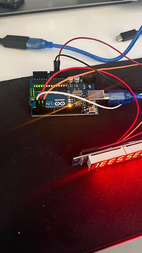

I connect to my Arduino UNO a 4 digit led screen with chip TM1637 that works fine.
I then change the module to MAX7219 with using the "LedControl.h".
Using simple example from the library, the screen shows gibrish and not the right output. Its also freeze or turned off randomly.
I think I am not doing something right.
Do I need a resistor
here?

This is what I am getting with your code.
Why I have gibrish on the left side? RIght side shows 4567
The sketch is working. Now, it is the question of display orientation. Take Fig-1 of post #4 as reference and use DMM/AVM to find DP0, DP1, ....., DP7 of your Display Unit. Your dipslay is good and functional. You see garbage on 4-digit as my sketch sends data for the DP0-DP3 positions.

The main problem is that for the first loop it can works fine but then on second/third loop its starts to show garbage.
Also many times the screen just freeze and not responding.
I tried with different unit but same results.

This module is totally unreelable or the library is unreelable.
I can make it works for time to time, but most of the time i am getting garbage on the display.
Sometime it turns on and sometime not.
I tried the TM1637 and it works fine.
What is going on here?
