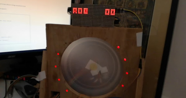

And if you're interested here's a link to my whole project as it's developed...
Right, looks like you are using a panel of matrices for text/graphics. For this application I would suggest you look at MD_MAXPanel. I wrote this one specifically to support 'game' type applications.
