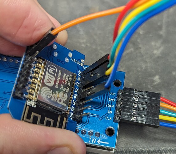

The schematic is not mine. But the connections on the Wemos and the Input are correct. I have done a continuity test on all of the wires to be sure. See the PIC to verify. Unless i am using the wrong PINs???
For clarity Here is the PIN out im using. This on a D1 clone.
My wiring
Can't see where the 5V 2A supply attaches?
Thats because i unplugged it to take the pic. its via USB micro in on the Wemos. Also i saw where i had D7 and D8 swapped in the PIC i have fixed those. Still no joy
You need to power the display directly from the 5V 2A power supply. You also need to power the microcontroller from the same supply, and you need a ground between the display and the microcontroller.
It sounds like you have the right power supply but are trying to power the display through the microcontroller, which shouldn't be done.
Also, about 90% sure that those displays are 5V and you are trying to power it off 3.3V.
I agree with @er_name_not_found
@siburmax you seem to have something connected to the 3V3 pin of the Wemos. If you try to power max7219 with 3.3V it won't work and you may burn the 3.3V regulator on the Wemos.
You can try powering the max7219 off the 5V pin of the Wemos, but that might theoretically melt the PCB tracks on the wemos. I doubt they were designed to carry 2A.
But so long as only a few LEDs are lit, like when displaying text/numbers on the matrix, the current requirement will be much lower and there won't be a problem. Just don't try to light 6x 8x8 LEDs at the same time!

Your schematic has CS on D8, CLK on D5, but your ESP32 pinout shows CS on D6 (15) and CLK on D5 (14). So why not put DATA on D7 (13) Remove the confusion. Show your sketch. Show your wiring.
Try this, using D5, D6, D7...
