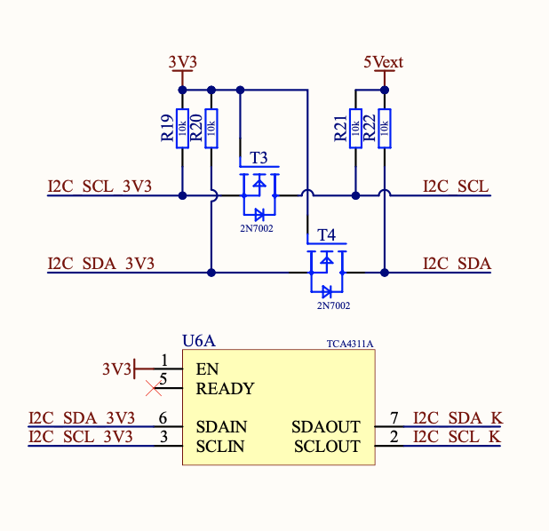

Sorry for the delay and the missing schema.

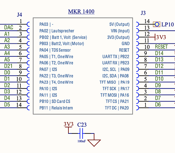

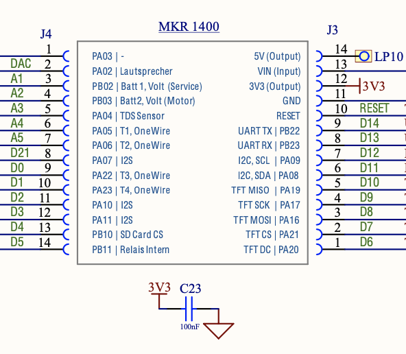

Arduino
Bildschirmfoto 2022-10-01 um 05.24.55
TCA4311 Hot Swappable 2-Wire Bus Buffer

Change your pull up resistors for maybe 4.7K for 5V and 3.3K for 3V3. Assuming the level shifter is wired correctly it should work. Run the I2C scan to verify that. This resistor change does two things for you. It lowers the impedance of the I2C circuits decreasing there sensitive to electrical noise. It also increases the switching speed from low to high giveing you a bit more time to get the message decoded. This is accomplished by overpowering the capacitance in the wiring.
You show a decoupling cap for the MKR. I don't see one mentioned for the MCP23017 or the TCA4311A.
